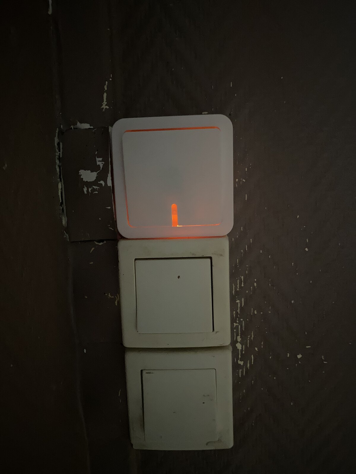

Resurrecting this thread as I have a similar issue in a house in France my partner has just bought.
We have just bought and fitted three light switches to replace the originals. Nothing wrong with originals but since these switches are for remote outside lights, we wanted visual indication that the light was on from inside the house.
To say the brightness of the tiny neon built in to them is abysmal is to do that word a dis-service !
So it got me thinking of an LED replacement, and via a google search to this thread… on a forum I was already a member of
The photo actually looks much brighter than in real life !
During daylight, it is virtually invisible.
So in the intervening years between this thread starting and now … has anyone discovered a bright LED replacement for neons ?
Easily room for a 5mm or bigger LED within the housing
Neil
