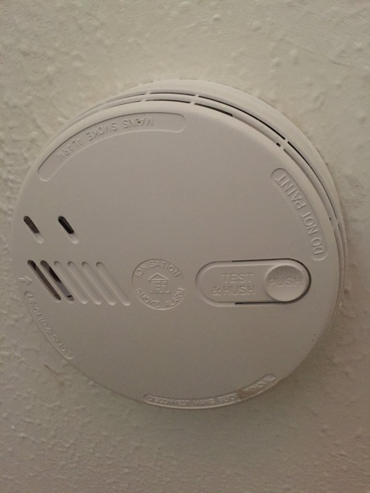

I had a set of interconnected smoke alarms installed throughout the house last year. Picture attached. I can see that there are two cables attached to most detectors (i assume not the last one but not traced this yet). However, when I push the test button, they only work independently and not as a set.
Any suggestions on what might be happening here please?

How long are you holding the test button down for ? Some brands require you to hold the button in longer to activate the other units
This is Aico detector and it looks isolated as no green light. When mains isolated, unplug head from the base and check if it has core(s) terminated to IC slot on the base for interconnect operation.
I will check the cables tomorrow and report back. I assume that power is being carried across to the devices as they are working independently? What’s the significance of the green light? Also, I didn’t hold the button down for too long
...What’s the significance of the green light? Also, I didn’t hold the button down for too long
This is mains powered smoke detector with backup 9V battery so if mains presents the green light is on. Green light must be on all the time.
Detectors may be wired up in different ways like a daisy chain from electric board or simply each one taking power from nearest light.
You will need flat terminal screwdriver to open it. If you are not experienced with this specific model download the manual first for removal instructions
https://www.aico.co.uk/wp-content/uploads/2016/05/Ei140RC-Series-Instuctions-Rev2.pdf
