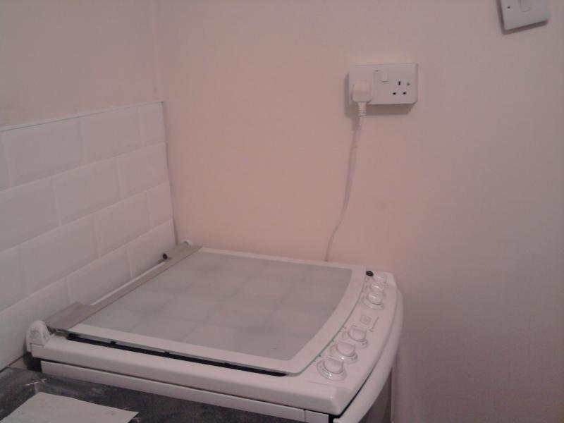

I have a double mains socket above the hob. It’s about 2 feet above the hob and on the right hand side of it. Is this acceptable?
Normally acceptable if its more than 300mm away from the edge of the hob. Bottom line is you shouldn't be reaching across the hob to turn the switch on or off.

It will be used for the extractor hood and the cooker ignition. Other appliances will be plugged in on the other side.
I will take measurements to make sure and post a picture soon. I have finished the wall and really don't want to relocate the socket now.

it would be much better if the socket outlet was used only for the hood and a feed taken to the hob at a lower level below worktop. It would be handy to have a means of isolation above the worktop for these appliances. But unfortunatelty you have finished the wall, so unless you can take a feed from elsewhere for the hob and consider using the double socket only for the use of the hood/extractor, you will need to remove tiles and chase out for cables.
Here is a picture of the location. So where would it be best to move the sockets? The feed is coming from below.
How about putting some trunking and running the cables for the cooker and hood in the trunking?
If the socket is move a bit more to the right would that be ok?

No, as the flex would still be far too close to the hob.
You should get rid of the socket altogether, put a couple of switched FCUs on the tiled wall to the left of the cooker, at least 300mm away, with the load cables chased into the wall vertically upwards to a flex outlet for the cooker hood and vertically downwards to a flex outlet for the cooker ignition.

TBF - as long as he provides alternative arrangements to power the cooker and hood he could just replace the socket front with a blanking plate and not have to re-do that wall.
You could consider making socket obsolete, change it to switched FCU and down fuse.
Then you could chase out in horizontal line from this plate to internal corner, then route your cable up the internal corner to suitable distance, then horizontal again above the cooker to offer a feed for your extractor.
This is a permitted safe zone and will not effect your tiles, so you will only need to re-plaster the chase and prime and paint it.
If the feed is coming from below for this socket, it would also be possible to arrange a feed for the hob ignition, below the worktop height. It could be positioned in the cupboard next to the cooker, which if correctly done would give you an isolation point, not in the best of spots, but nevertheless a point of isolation and again not having to remove any tiles but may have to do some chasing out.
