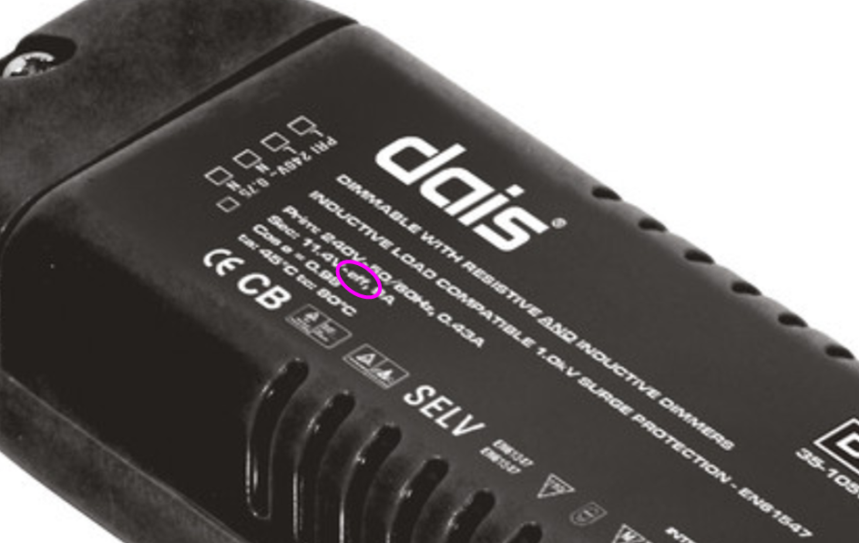

Mains to 12v
Oh thanks for that. I thought it was a dc output.
Oh well back to the drawing board

Using LED power supplies, and caravan and boat power supplies you can get 12 volt DC however the latter are often designed to have batteries attached to smooth the DC.
