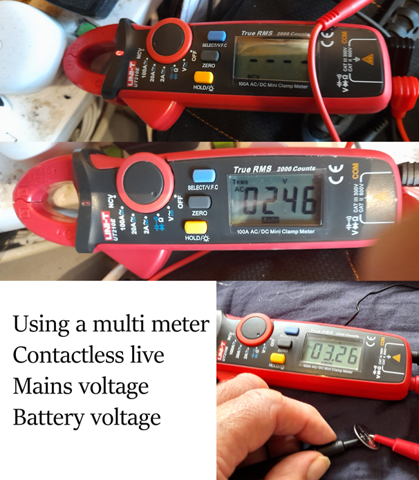

I decided to actually try using my new toy, Multi-meter-small.jpg the one thing I did not try was to measure current, but did that when I first got it. What I found odd was having to select AC or DC, simply not use to using a select button, unlike my old meter you can't simply look at the selector switch, one needs to read the display to see if AC or DC shown.
The whole idea of the clamp on meter is there is no range you can select which will damage the meter when you stick in the probes, however with any MULTI meter the user still needs to turn it on to correct setting.
I saw this when doing my 'A' level physics, guess what happens if you try reading volts on the amps range? And it seemed ½ the class did that judging on the number of fuses required. Not me, that would have been rather embarrassing, but I do wonder if I should stop playing?
