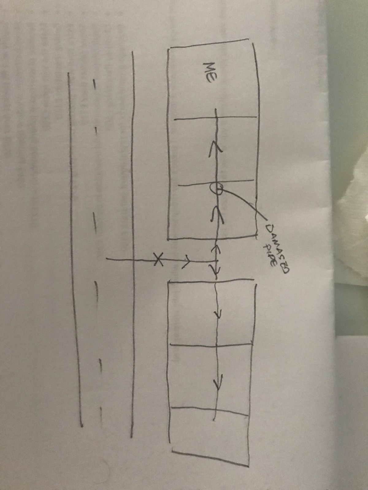

I have a shared mains water supply starting two doors along and have low / no water pressure at my property since an extension was completed at my neighbour’s property.
The builder said they found a damaged pipe which got worse as they excavated - I don’t know if they hit the pipe and damaged it from fresh but I think it’s irrelevant anyway.
The pipe was repaired although, the builder stated it is badly corroded and a very small bore left.
The affect on my house is that at times the pressure is “ok” (Affinity Water state it’s acceptable) and others I have literally no water flowing from any outlet (so much so that it has stopped mid-shower and been left with soap on my body waiting for the water to come back).
My neighbours don’t have the same issues, so perhaps it’s the supply only on my land - I’m not sure if that changes anything with the shared supply rules.
I have contacted Affinity Water who have said it’s a shared supply and they’re not responsible for fixing it after it goes from the pavement to private land.
Does anyone have any experience of how I can challenge this?

I'm pretty sure they're legally obliged to supply you, fresh water is a basic legal right in this country. Was your house split off from next door at some point, and do you pay your bill directly or via next door?
Diagram shows the layout
Is it continuously worse than before, or is it just worse intermittently? I wonder whether your neighbours have had a pump installed and that's starving your supply...?
