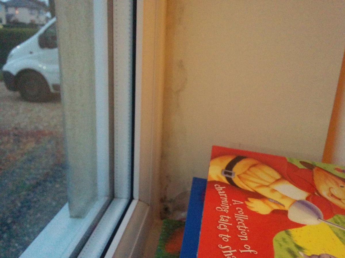

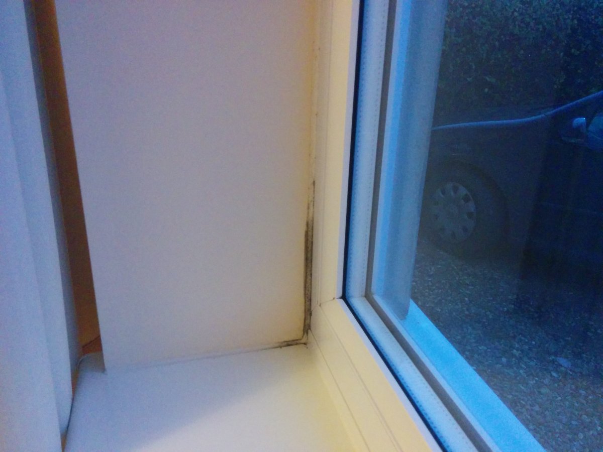

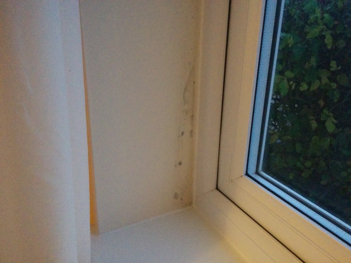

Hi people... Update for you all....
Nige F - No Chimneys....
Woody - Thanks for the reply.... Im not 100% sure it is due to the lack of cavity closers, but the more and more I read on the internet regarding cavity closers, it sounds like my problem... Keep reading that they stop cold / thermal bridging which they say can cause mould on the reveals etc....
Like I have said, the rest of the house is all good, its just these 2 front rooms, which I can remember no cavity closers were put in these 2 rooms, everywhere else cavity closers were fitted...
I also started to read up on windows, where they should be positioned... I read that the actual window should go where the cavity is... I cant get my head around this, because where do you fix to if the cavity is open ? Surely you cant screw into the cavity closer because its just a thin piece of plastic....
All my windows have been screwed through the plastic frame into the external block.... Is this maybe my problem with the 2 front rooms....
I have added a few pics, showing the mould, you will notice how far forward the windows are, being screwed into the external blocks, rather than where the actual cavity is.....
Also, you will notice the mould patch is only about 1" deep...
Any more help would be much appreciated....

Hi John D,
I must admit the photos are not that good.... The photos look like water marks...
That's from when I have rubbed / cleaned the mould it left "marks"... before it was just black mould....
I don't think it can be water penetration... The outside is completely sealed with new render and prior to the render, the windows had been sealed with silicon...
