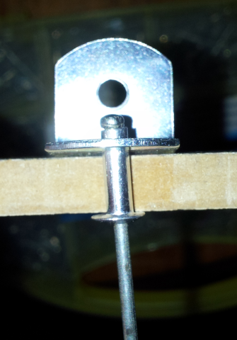

I was in the middle of throwing out boards of a decommissioned laminate floor, and suddenly realised what amazing precision materials they are. So I want to make boxes out of them. I have lots of junk of all sorts and always need boxes. So, I want to turn the boards into boxes.
Can I have some suggestions on how to make boxes from them? I have no woodworking skills. I need something very simple to do and strong in construction. I am thinking of using metal angle brackets, wood beam piece to screw into in the internal corners, or somehow glue them together. Any woodies have a better idea?

I am going to get the brackets now. I may have a prototype box ready tonight if my rivets are compatible.

I am in luck, the fixing is compatible. Although I will have to buy bulk. The minimum is 12 sets for each box of 450mm x 215mm. The long side is chosen to match my garage shelving. The short side is just the width of a plank. For small boxes, the 8mm planks are rigid stiff. For reinforcement, a bead of hybrid polymer in the internal corners of the box will work, but I don't see needed.
If you are riveting the brackets it would be prudent to fit a close diameter repair type washer each side to spread the pressure against the board surface.
It will also stop the rivet head pulling into the board at the open end.
