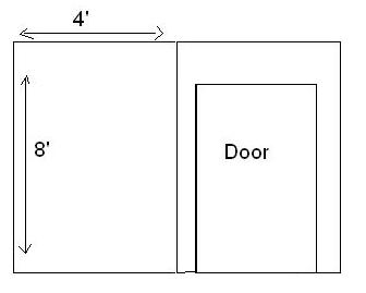

A fundamental question has to be how do you intend to fix the plywood in place? You will presumably need to secure the plywood top and bottom with some form of metal track section or timber framework
Timber frame work
Then how do you intend to hinge the doors? Presumably you intend to have a door which is something like 1800 to 2000mm tall x 750mm wide? That in turn seems to imply that some form of framing (e.g. metal or 44x 44mm CLS softwood or the like) running floor to ceiling around the door openings would be required around the door opening to provide sufficient stiffness (even 25mm plywood can flex and bow) as well as something to fix hinges to, because.edge grain plywood has no strength (screws driven into it will pull out very easily which is not much use for conventional butt type hinges)
Just use standard door hinges; from the door to the wall, as for framing I dont know yet!

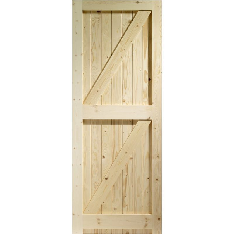

LBF means Ledged, Braced and Framed, to give the door strength and rigidity.
This picture shows a door made of boards. The horizontal pieces are called ledges. You'll need as a minimum one at the top and one at the bottom. The middle one improves it and you can put a lock there.
The diagonals are called Braces, to prevent the door sagging and to carry the weight to the hinges. As your door is faced with ply these are less important.
A Frame is reinforcement going all round the sides top and bottom, which greatly improves strength and rigidity and allows you to fit hinges, bolts and locks.
The cut edges of ply allow water to penetrate which will quickly degrade it and it will fall apart. Lipping on a door is strip of wood fixed to the edges to protect and seal them

Here's one,
But Do you think I need LBF on 1" plywood then fiber glass coated boarding?

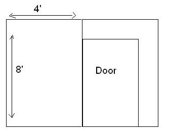

Draw a sketch of what you're planning to d
o
Hope this helps
3in or 4in butt hinges won't hold into the edge of plywood. They are also wider than the plywood is thick. That's partly why you'll need to frame out around the door openings or reconsider your hinge type (to a type which face fixes)

sure I would if I could do, but no scanner.
Not even a phone with a camera? (Draw sketch, open phone camera, take photo of sketch, upload)

so should the hinges screw into a frame and a frame into the door right?
I did upload a computer schech; please see above
