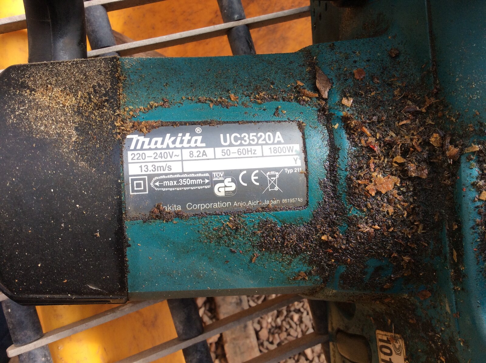

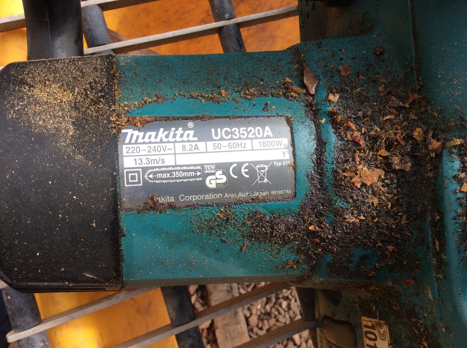

Makita Chainsaw UC 4020A 1800 watt
Could anybody tell me what sharpener I require for this saw, loads on the web don't know the right one..

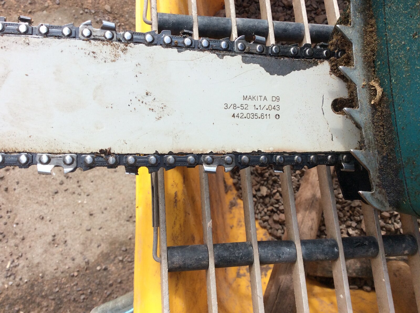

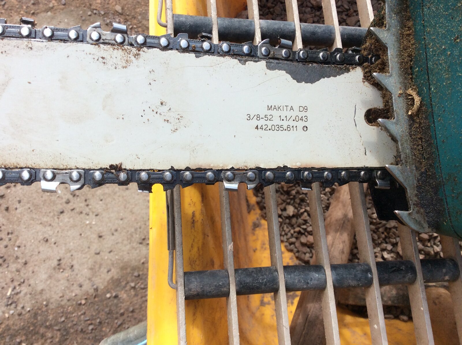

If you look on the bar near the engine, usually the chain info is stamped into or printed onto it there
On mine: D94D5F39-D3DA-44AA-96C3-4F554882F634.jpeg
