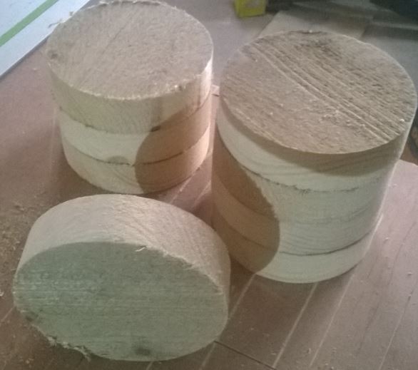

I have now used the DJV181z for some time and I have seriously started to use jigsaw as a tool 5x more than I used to do.
here's my quick review on it:
-at first when when you see it, It looks bigger than you expect it to be, however it slowly grows on you and feels just normal in few days.
-at first the control actually felt weird on it ( barrel grip) , and I was thinking about sending it back and swap for D-handle one, but again, It grew on me and I find it comfortable now.
-Compared to my old Jigsaw -Bosch GST135 this is a total Night&day, it has smooth power delivery,you aren't afraid to use it because it might snap at you when something wobbles etc, It cuts rather straight, ok I have measured it constantly cuts at 88.9-90degrees so NOT perfect, but it's a jigsaw and that's what they do,my old bosch If I was lucky it cut at MAYBE 85-86 degrees on a good day for a thick piece-it was that bad....

... I have measured it constantly cuts at 88.9-90degrees so NOT perfect, but it's a jigsaw and that's what they do,my old bosch If I was lucky it cut at MAYBE 85-86 degrees on a good day for a thick piece-it was that bad....
Not all of them :D
and I think we'd already established that your GST135BCE was hardly in the best of condition. You never did tell us what blades you were using (and whose). I'm often surprised at how quickly some blades degrade if you cut tight curves with them - particularly the cheaper carbon steel ones. I think a lot of people aren't aware of how quickly jigsaw blades blunt and so keep on using them until there are virtully no teeth left. And more than a few of the guys I've worked with nover the years have no idea of what is available in terms of blades, nor of how to choose an appropriate blade for the task at hand (and contract managers are generally just plain ignorant). And they're joiners
