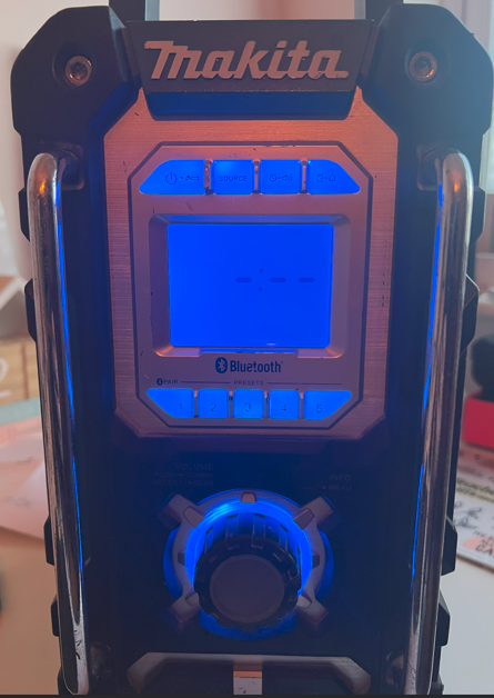

This radio is playing up. It’s either unresponsive or toggles through random settings such as the time. The “source” button is not having any effect.
I tried two Makita batteries without any success. I also replaced the AA batteries.
I would welcome any suggestions. Thanks

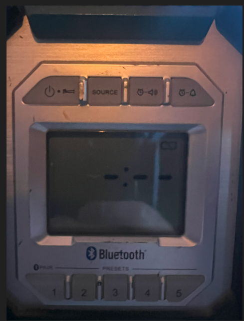

When I put new AA batteries into the back (with no Makita battery), I get this:
It does initially display "Power Fail" but I didn't manage to catch that in the above image. "Fail" flashes a few times.

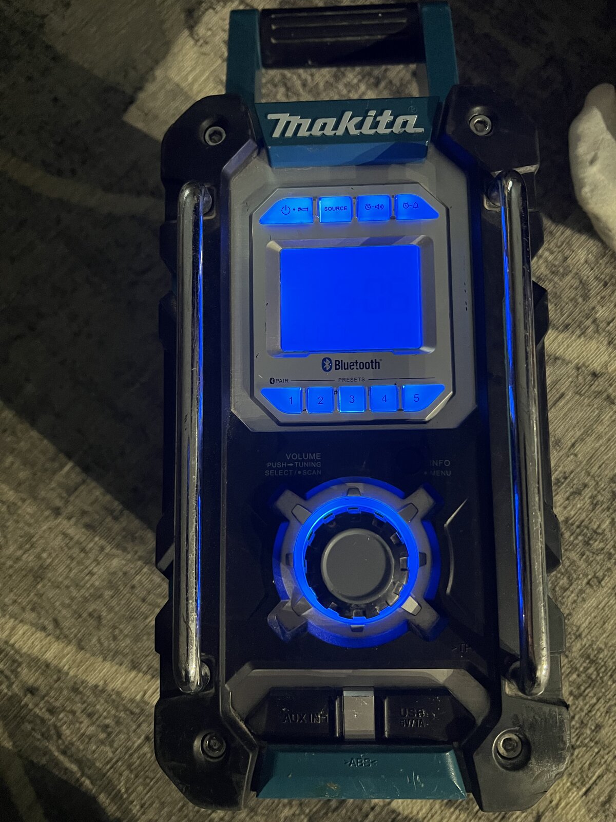

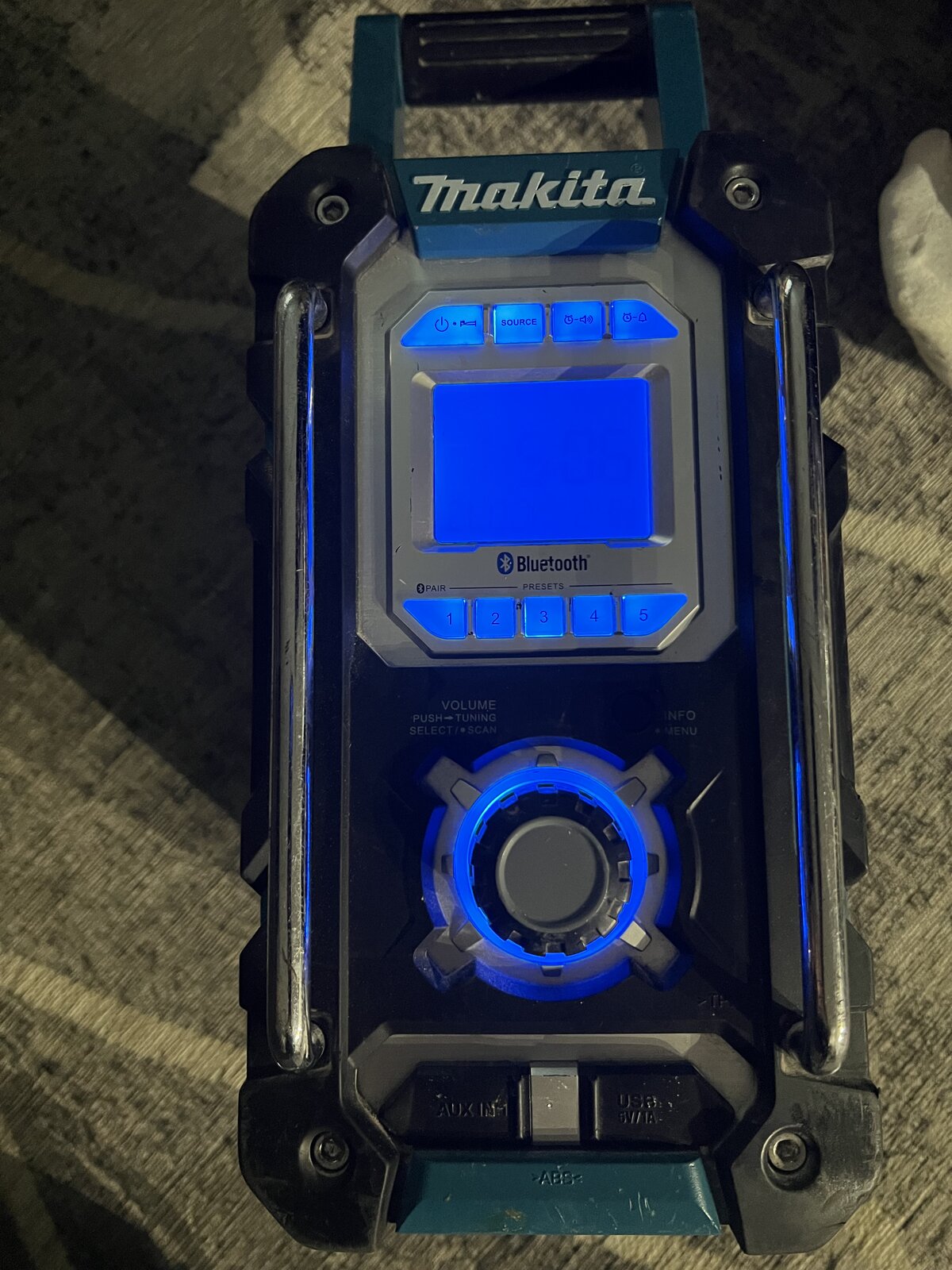

Additionally, when I insert a fully charged Makita battery, I get this:
It lights up but no buttons have any effect. I no longer get any random settings whatsoever. It will stay in his state until the Makita battery is drained. I left it overnight.

Time to replace, the electronics are gone, possibly through damp or immersion in water.
