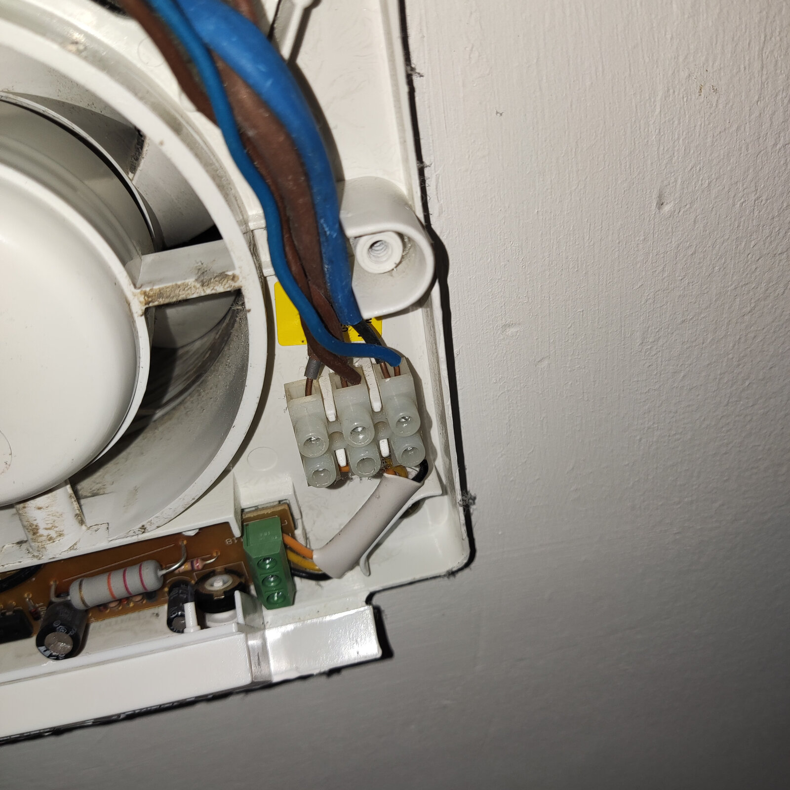

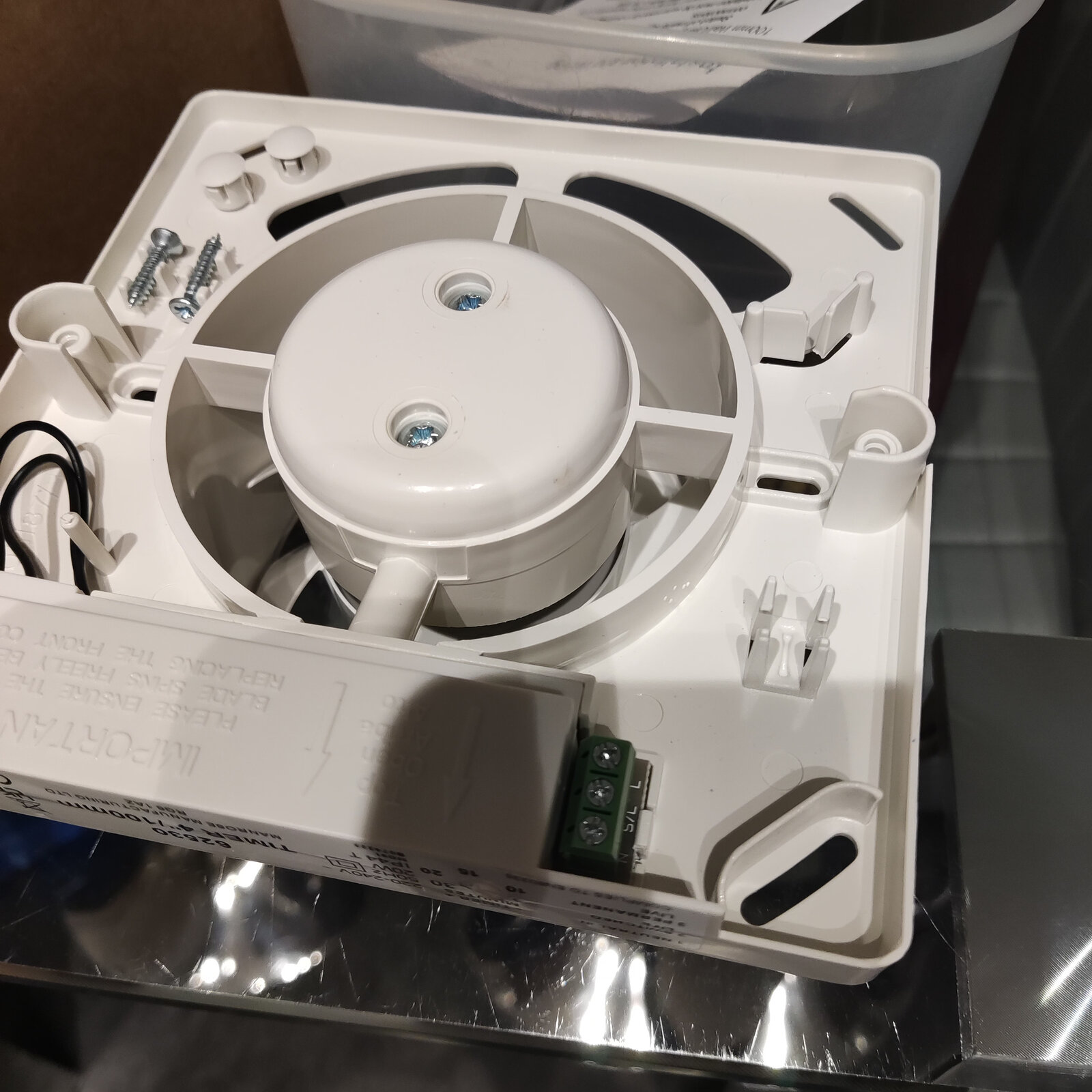

my manrose extractor fan suddenly stopped so bought this new one on opening Found no wiring to connect to a terminal block so was planning on using the existing thin wiring from the terminal block to the transformer aee attached picture of New and existing installation

If the internal wiring connections are missing return the item and don't use it. The wiring into L SL and N is from the old cable.

Not sure I agree with this. There are connections that are useable on the new fan

As far as I can see the internal connections and wiring are all there, but the OP seems convinced otherwise, or is confused.

The connectors on the end of the timer PCB are, as usual, present, and could be used for connection of the supply (provided the conductors would fit into those small terminals), but what I presume is intended (as in the OP's old fan, and has been the case in every other Manrose fan I've seen) is that those small terminals are connected by ('thin') wires to a bit of normal-sized 'chock-block' for connection of the supply cable.

yes that's exactly what I mean. i have 2 supply heavier cables into a chock block. so i was just planning on using the same thinner wires drom the block to the timer pcb.
surprised though there's no wires already from the PCB or any in the box though understand that maybe the main supply can go into here

Indeed, if you want to keep with that one (rather than trying to get it swapped fro one which does have the chock block), I think that would be the only sensible course. As has been said, trying to get 'stiff' T+E conductors into those terminals could easily result in that timer PCB getting 'cracked'.

I'm also surprised and, despite the suggestion that 'up-to-date' ones may be different, I've personally never seen a Manrose fan without a bit of chock block.
