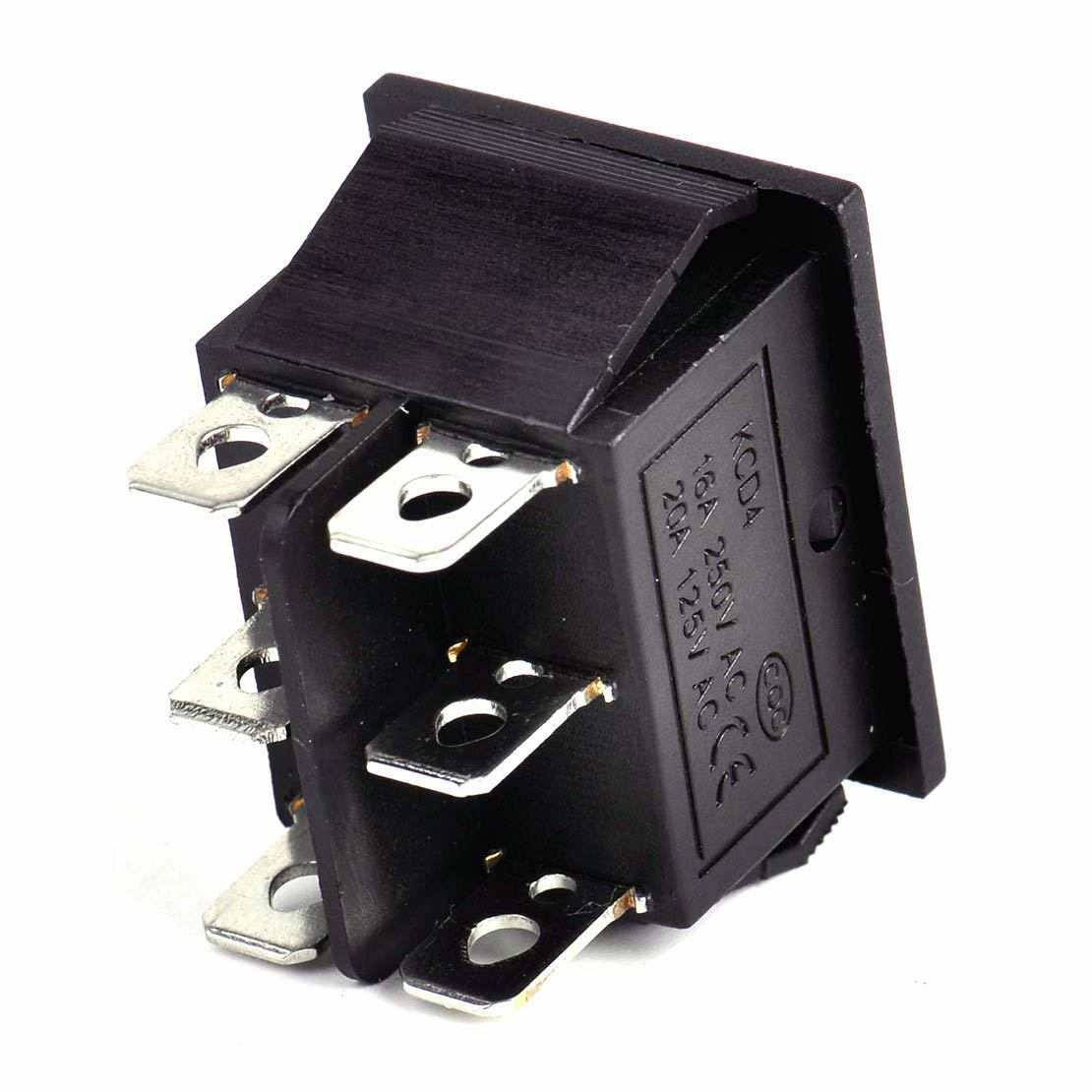

Not really. I couldn't find it. However, I took off the inner plastic lining of the hatch, and identified the unlocking motor. I drilled a small hole in the cover, and tied a nylon cord to the unlocking end, led it through the hole, and fixed a toggle on it, so that pulling the toggle unlocked the boot.
It would have been possible to fit a lever handle, but you'd want it up by the back window so you can reach it leaning over the back seat.
I later bought a battery case, which I put 8 AA batteries in, and bought a momentary DPDT switch, with centre "off" position (I think it might be used for electric windows) so I could electrically lock and unlock the boot. I could probably have wired it to operate all the locks, and taken a power supply from the car, but I couldn't be bothered to identify the car wiring. Finding out the switch is called DPDT made it easy to find on ebay.
You need one with six pins.
Power in through the middle two, out through top L and R, and through bottom R and L (crossed over to reverse polarity for open and shut). It does not matter that they are connected together, because the switch can never put power through both ends at the same time.
