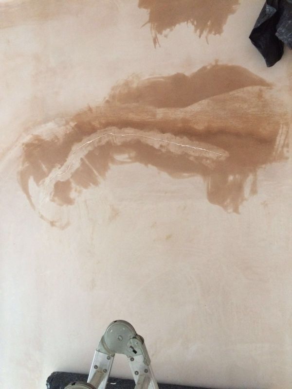

2) I splatted the walls, quite a bit in some sections, so i rubbed off this paint with a damp cloth as i wasn't yet ready to paint the walls. All was fine until i wiped one section & either side of where i've put a red X darkened up with the damp cloth but not this sweeping bit...
After it was damp i touched it & it was very sticky. I'm guessing probably the famous PVA?
I painted it with a brush & it seemed to cover ok (which i then wiped off). Whether it actually sticks to the plaster ok is another matter, but i wiped it off with the intention of coming here & seeing if i should prep it some way beforehand?
But then even where i have put filler had the same result & this didn't have PVA on top...

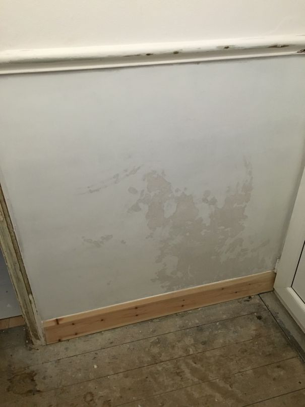

What is that & why is it doing it?
Wall has been totally tanked using the K11 system. No salts or anything were forming on top. The plaster wasn't different in that section to the rest of the wall. It didn't feel colder than any of the rest of the wall.
This is only the first mist coat & who knows, subsequent coats may cover it. Though like everything else with this house, i doubt it. I just wondered why it looked like that, or a possible reason as to why?

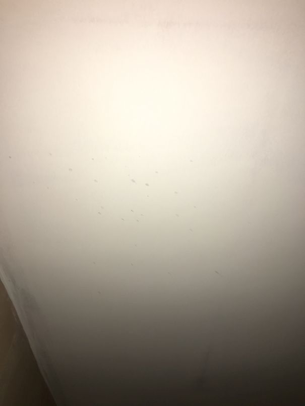

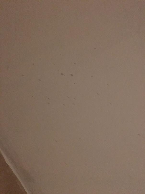

Not so sure about these splat marks though. I don't even know what they are...
Same marks, just with & without flash.
They weren't there after the original plastering job back in 2013/2014 whenever it was so it must've been from the most recent job (December 2015) when the wall next to it was done.

I'm guessing that PVA is the culprit here as the patches you show resemble what happens when the finish skim is contaminated with it. I suppose it could be something in the tanking system reacting with the plaster but imagine that is less likely.
You will probably find, if it is PVA, that further coats of paint will begin to cover the patches, but you could encounter the worst case scenario and have the paint lift as you paint over it. Trying it is the only way to find out, but I think that Gardz may be the safest option.
