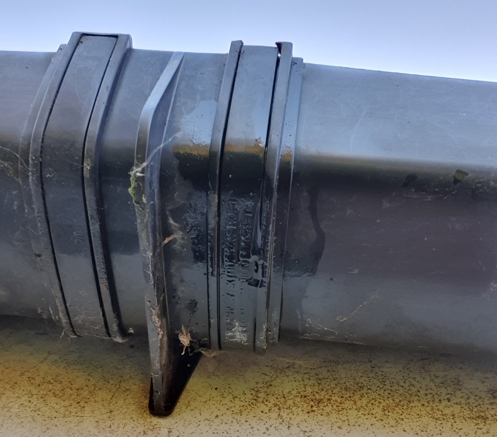

Hi,
Our house was built in late 1994, we think it is fitted with Marley Flowline guttering, in black
One joint has just spung a bad leak, looks like the clip on the joint has failed and is no longer clamping tight, see pic
Can we locate a replacement clip? Can we eck! Closest available Marley clip is ogee shape, I dont think that will fit or clamp
Any suggestions for source of suitable clip gratefully received
Alan

It doesn't look like the clip has failed - more likely that the rubber seal inside has perished. but the replacement Marley bracket shown will come with new rubber seals so you could either extract these and fit them to your existing bracket or, better, replace the whole bracket
You can clearly see that the top part of the clip has broken. Whole joint/bracket replacement should sort it
