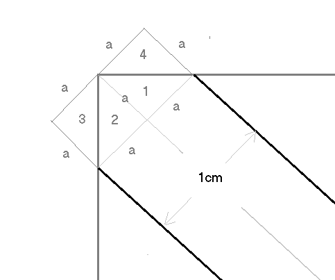

Ok. You don't have to calculate the volume of the point or the missing parts around it.
2D diagram:
All sides 'a' are 0.5cm.
The missing triangles '3' and '4' are the same size as triangles '1' and '2' - so must be the same as the equivalent '1' and '2' at the other end of the hole.
Therefore if you deduct just one 'a' from the vortex to vortex length (17.32 - 0.5 = 16.82), you actually have the area of the missing part
Therefore, by extension, this must also apply 3D cubes.
In cuboids, though , where the entry and exit angle will not be 45°, you would have to calculate 'a' (well, we have in your example; it was just very easy).

Sorry, it's a cylinder going through it, more complex I am afraid.

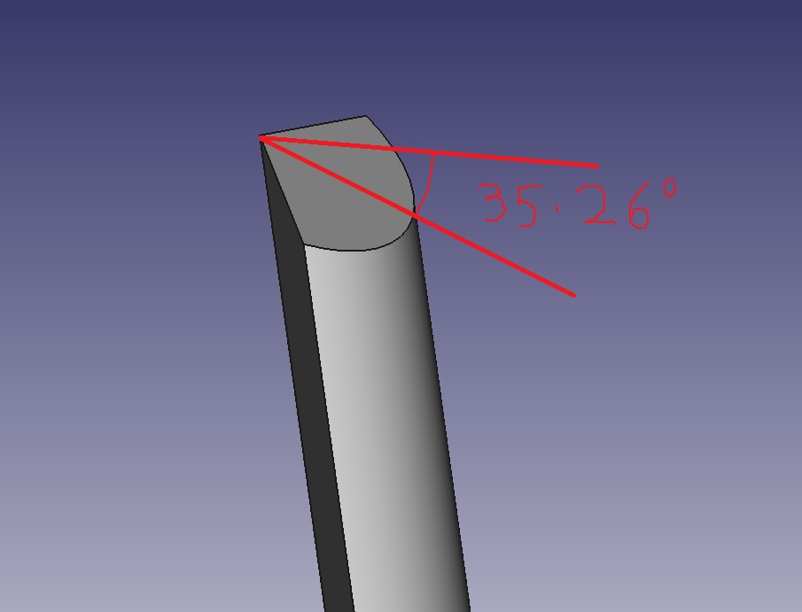

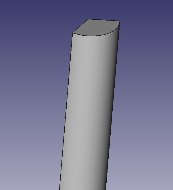

fret ye not. Understanding the problem itself is quite challenging, let alone the answer!
If you take the vertex to vertex measurement of 17.32 (are we agreed on that?) and calculate a cylinder - including the actually missed parts - then that cylinder is 13.60 cu.cm.
That is 1000 - 13.60 = 986.4 therefore the true answer MUST be higher than 98.64%.
I think the only way to calculate this, is to take that 'new cylinder' and cut it into three 120° strips...
Then, we need to cut off a chip, at, I think, 35.26 degrees (because that's the angle of a right triangle of side √2 and hypotenuse √3)...
(i.e. if you had three of these and put them together, you would get a 'cube corner ended cylinder')
Doesn't mean I know how to actually give an answer still!! But once we know the volume of that 'chip', we can times that by six and take that away from the 'new cylinder' mentioned before.
