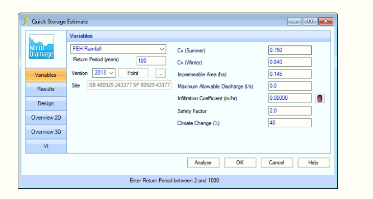

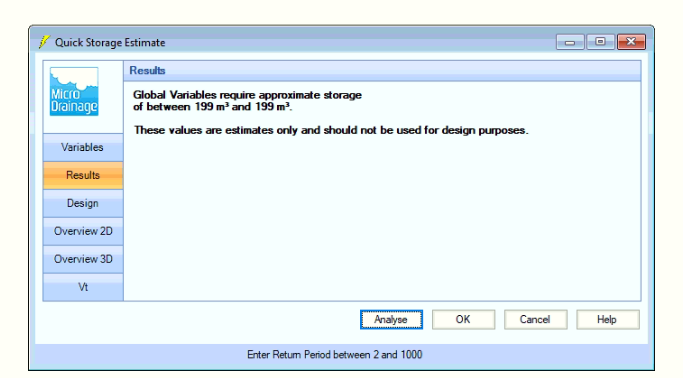

Hi guys,
I have been tasked with doing some drainage work incorporating cellular crates if possible below the ground level.
If someone can give me information regarding where I can find out about maximum allowable discharges would be great.
here's what I have on microdrainage at the minute -

Yeah I already have quite a lot of the information required only a concept drainage strategy anyway prob just gonna design a hydrobrake but again if you know where I can find details on maximum discharges would be great
