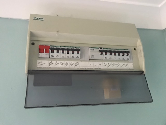

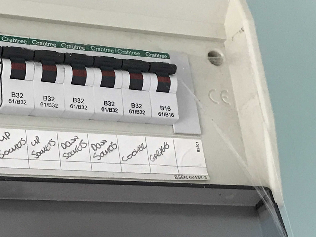

Looking for some advice before I call an electrician...
I accidentally tripped the circuit breaker when replacing a light fitting in my garage. The MCB for the garage tripped as well as the overall RCCB. (The trip was totally my fault and it proved the circuit protection devices did their job).
When I reset the RCCB the rest of the house is fine. When I switched the MCB for garage circuit back on it stayed on, but there is no power in the garage at all. I tried to reset the MCB again. It stays on no problem, but there is no power in the garage.
Has this trip damaged the MCB? Is there anything else I can check before calling someone out?

A very good question! I also assumed there must be another failsafe device in the circuit, but as far as I can see, there is nothing between the consumer unit and the first socket in the garage. At least if there is, it's not at all obvious! :D
I think I will need to call someone to check the MCB in the consumer unit - to check there is current coming across it...

I'm fairly sure there is no power reaching the garage, so I guess the problem must be in the consumer unit.

It's certainly unlikely that any wiring will have been damaged as a result of what happened (particularly since the MCB tripped and therefore terminated the problem very quickly), so what you say seems the case - the most likely thing being that the experience has 'killed' the MCB. I suppose it's just about conceivable that a very poor connection somewhere could have failed completely as a result of the very brief, but probably very high, fault current, but I would think that was pretty unlikely.

Thanks, I think I will admit defeat and call someone to diagnose and fix the problem. Can't tell you how annoyed I am with myself for stupidly causing this situation, but on the bright side, I'm grateful the MCB did its job.
