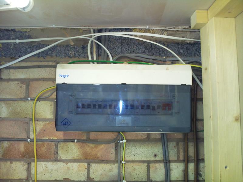

Hi guys,
I have an MCB that keeps tripping, and I have no idea whatsoever on what is causing this. I have been around the house checked if the sockets & lights are on, and all are fine. We have no wired smoke alarms, and the house alarm still has supply, as well as the porch light.
I just can’t find what this MCB is for, let alone why it’s tripping?
How do I go about finding out what this is wired to? Could I remove the front panel off of the consumer unit and see what thickness wire is connected to this to identify what type of circuit this will be?
The MCB is a Hager b16.
Any help will be appreciated!
Cheers, Adam.

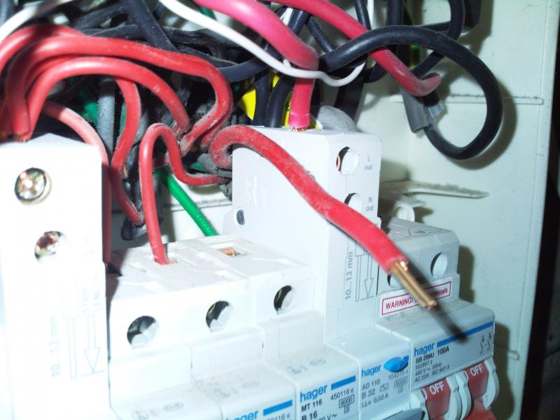

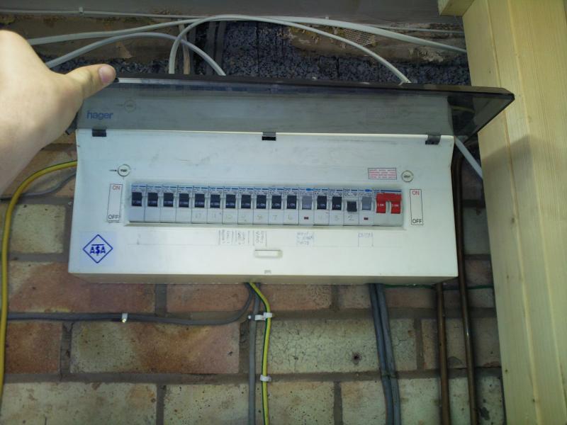

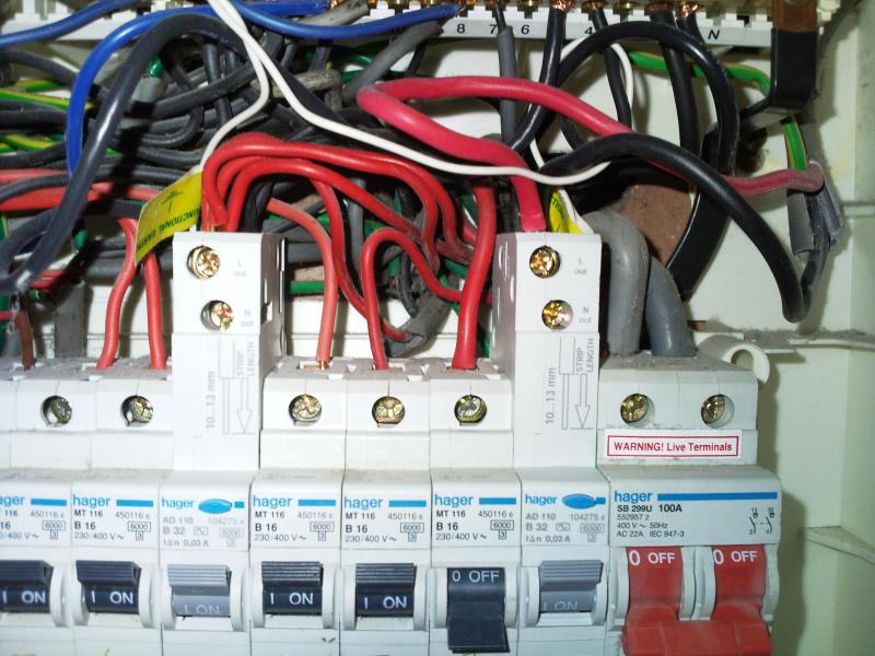

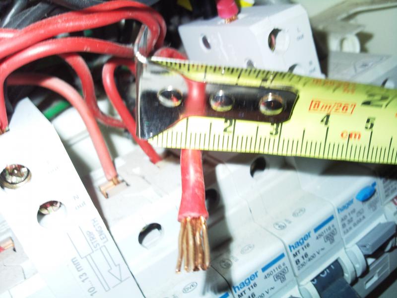

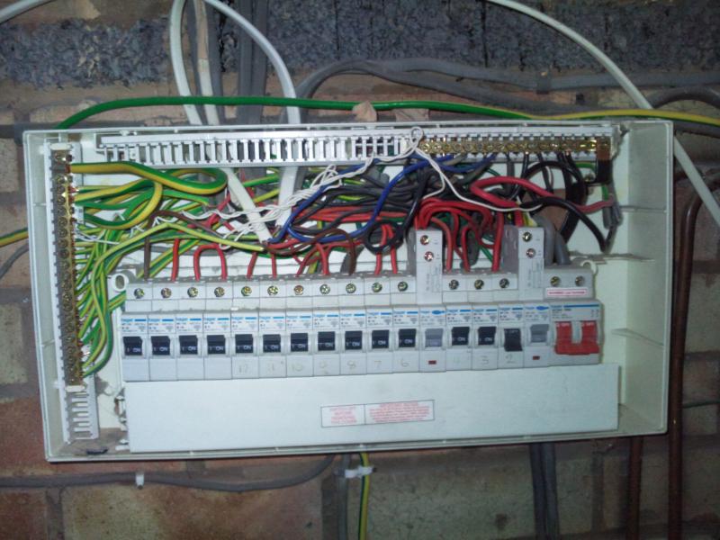

Removed the cover from the consumer unit this morning, and the cable wired to the MCB is not labelled up, and goes straight through the back of the consumer unit through the wall.
Is there anything I could do to 'trace' the cable? It's almost a month since the MCB has been OFF now, and still haven't noticed anything around the house to not be working.
I would still like to find out what this is for though...
Pictures attached.
Cheers
-Adam
