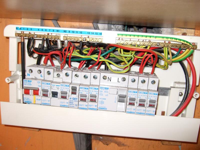

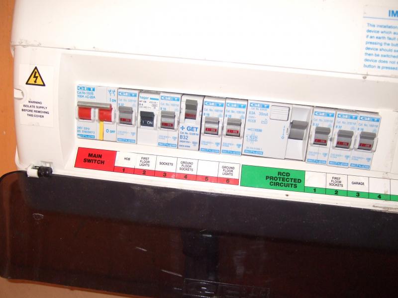

An interesting view inside the CU, and especially the old cables just visible above it.
Who installed it?
If, as you say, it trips when none of those heavy loads are on :confused: then I would suspect cable damage as described above.
