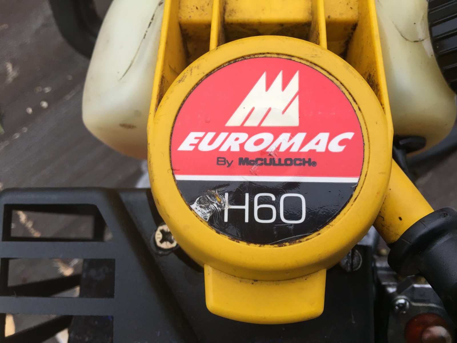

Just purchased the following.

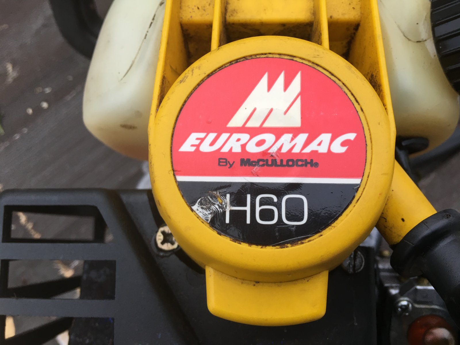

McCulloch Euroma H60 hedge trimmer.
Im looking to purchase a new spark plug preferably NGK
Anybody have a prt number.
Ive contacted McCulloch & NGK & both a waste of time.
I cant go by the plug fitted as its finger tight & not sure if its the correct item
Give me a pic of the thing and I’ll have a go.....if its short but with a large hexagon then BPMR7A won’t be far off.

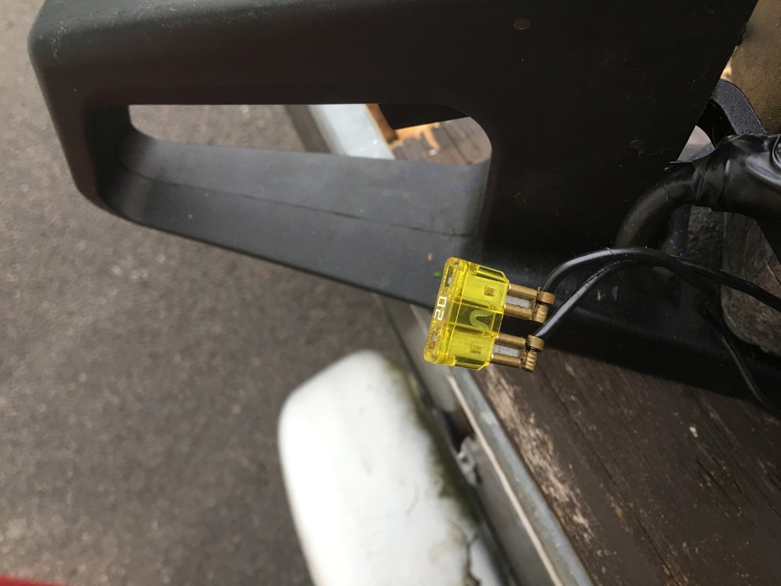

First i must ask,the on / off switch is missing so they have connected the two wires through a fuse.
When you start these petrol items you put the switch to on & start it up then off to kill the engine.
My question is what is on when using this fuse Connected or Disconnected ?
So not knowing if the fuse is to be connected or disconnected for the on position i have done the following variations.
Fuse connected & then fuse disconnected.

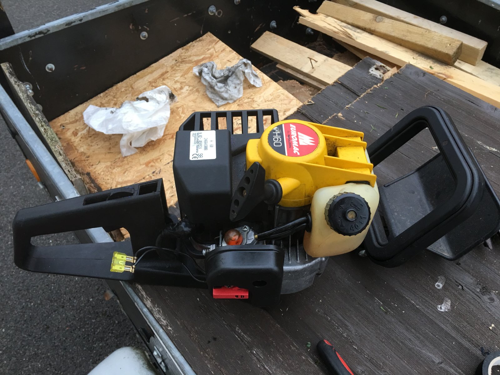

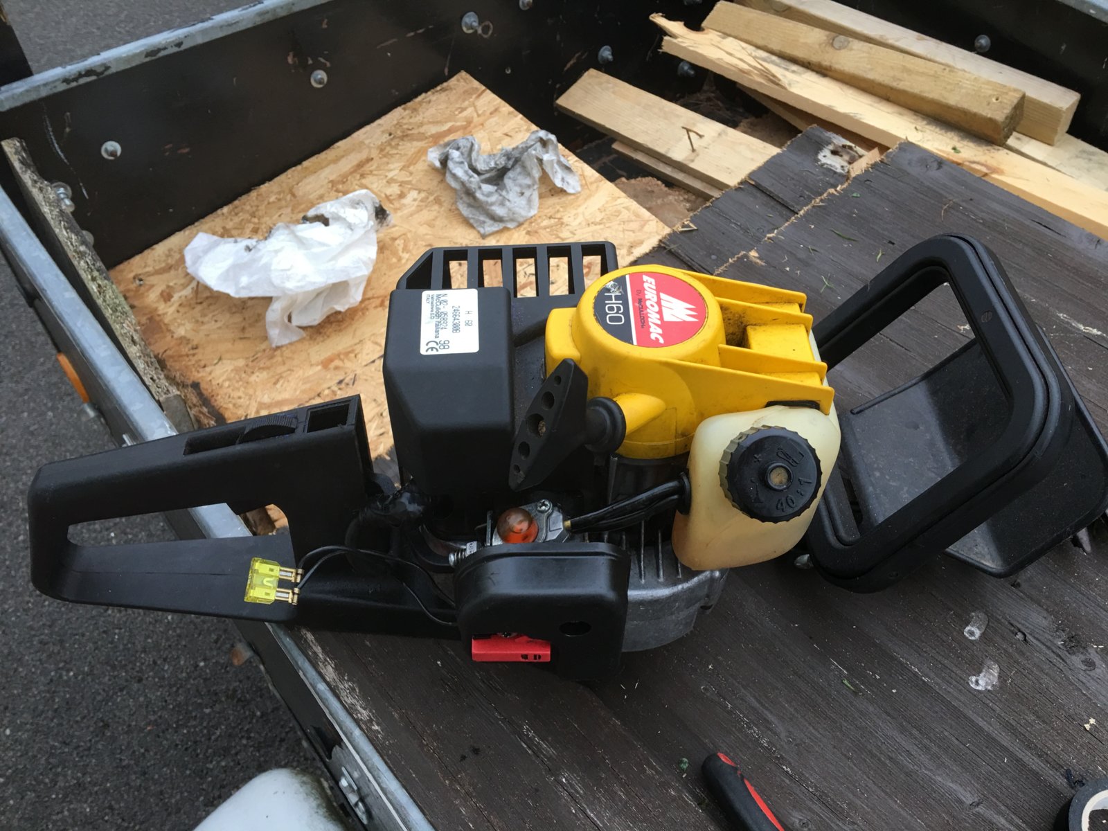

Here are some photos attached.
As you can see the fuse is connected so would this be the same as the switch in the ON or OFF position ?
I have removed foam air filter and also exhaust.
Still no joy.

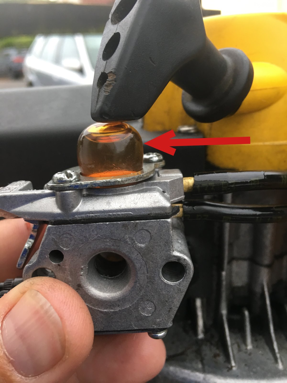

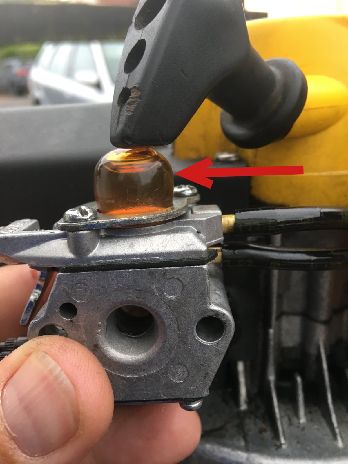

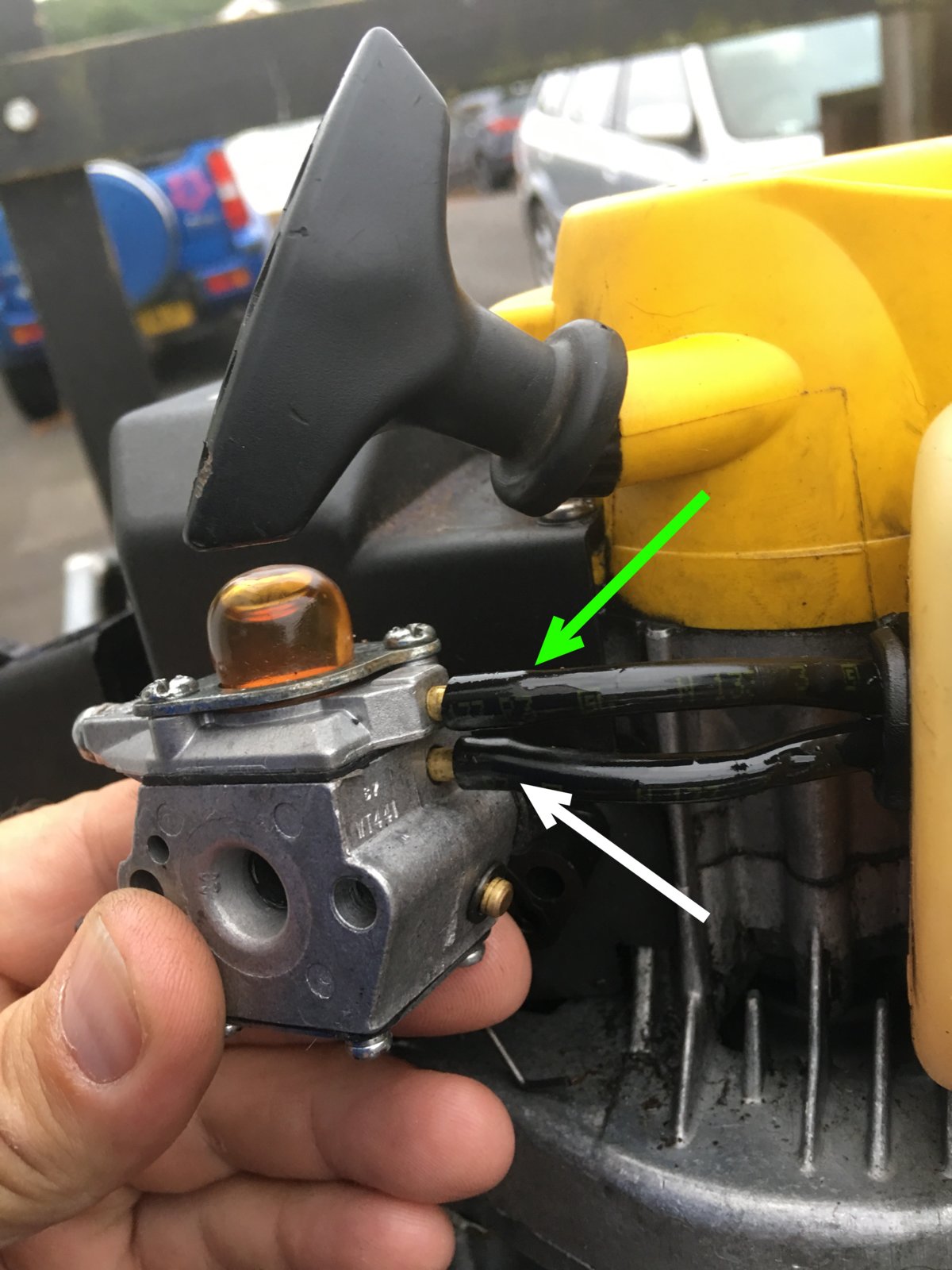

With the air filter and carb off should i then operate the lever the operates the flap inside the carb should I see a squirt of fuel as I don’t.
Primer bulb seems to stay full of fuel.
If I pump it I also don’t see a squirt of fuel.
Here is the full primer bulb.

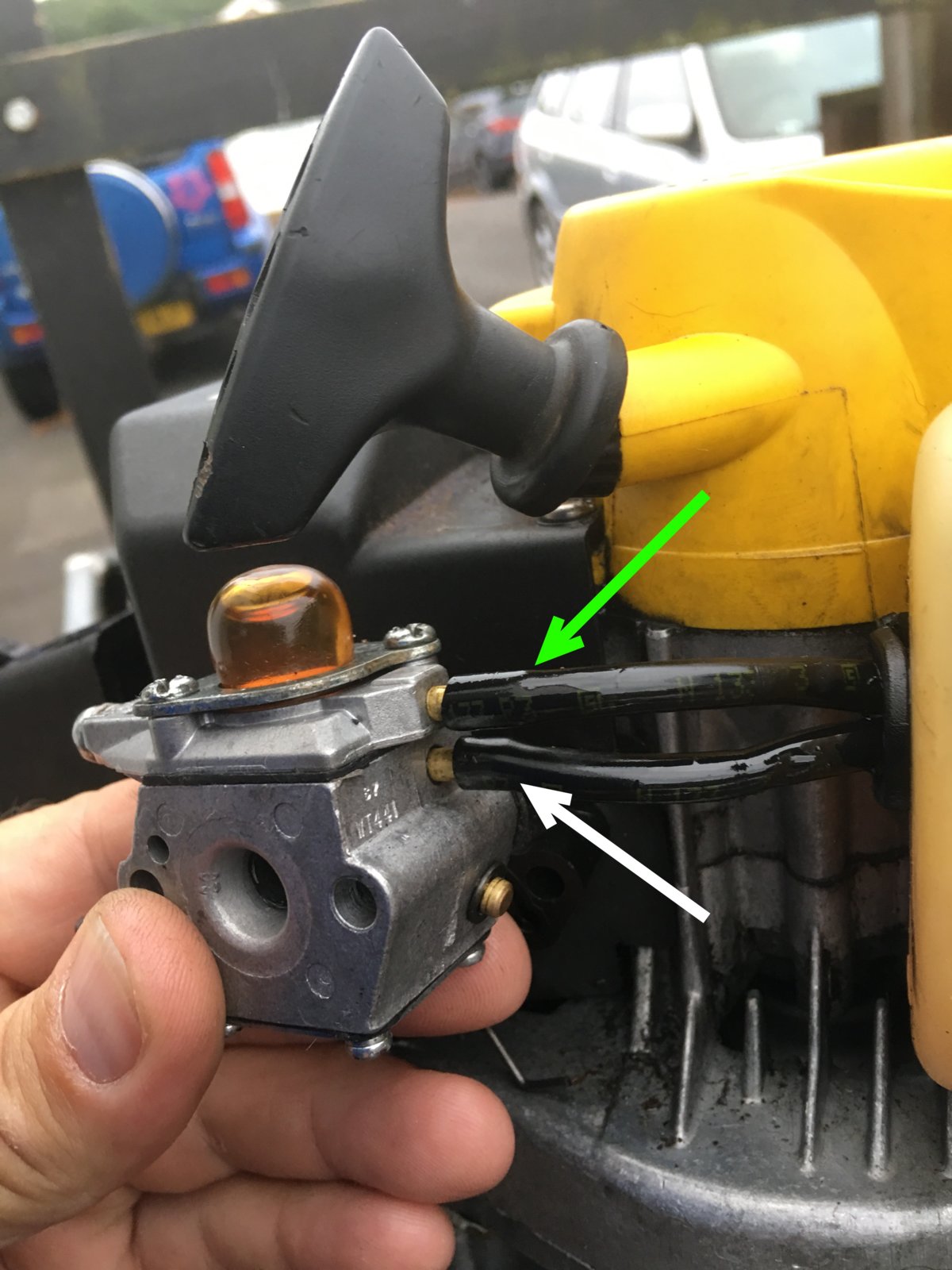

Also asking if fuel pipes are on the correct way around.
Top hose green has fuel filter on it.
Bottom hose white is just placed in the fuel tank.

Who knows why a fuse has been used here.....it certainly isnt necessary but I would imagine you would only get a spark with the fuse removed - do check it!
A full primer bulb is a good sign but isnt an indication that fuel is being drawn into the engine, unfortunately.
Does the spark plug ever seem to be wet with fuel?
Just to ascertain the engine isnt flooded, take the plug out, turn the machine so the plug hole is downwards and pull the engine over. Any spray of fuel here shows flooding.
John :)

With the fuse removed then the wire isn't grounded so I left it off.

With these engines, pushing the primer button does not give a squirt of fuel at the carb jet.....it simply fills up the chambers of the carb, ready for the fuel to be sucked into the engine.
Vent the engine as I said in post #8 then:
Give the engine full choke and full throttle, pull the starter briskly until the engine fires once then;
Full throttle, no choke, pull again and the thing should start.

The fuse was only used i assume as a kill switch as the on / off kill switch is missing.
Not sure why he used a fuse as he could of just touched the wire to the engine.
