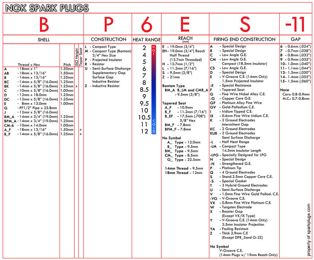

I am planning to do my first ever car maintenance so I'm an absolute newbie. I haven't bought any tools yet, so I'm trying to find out which tools I need to order.

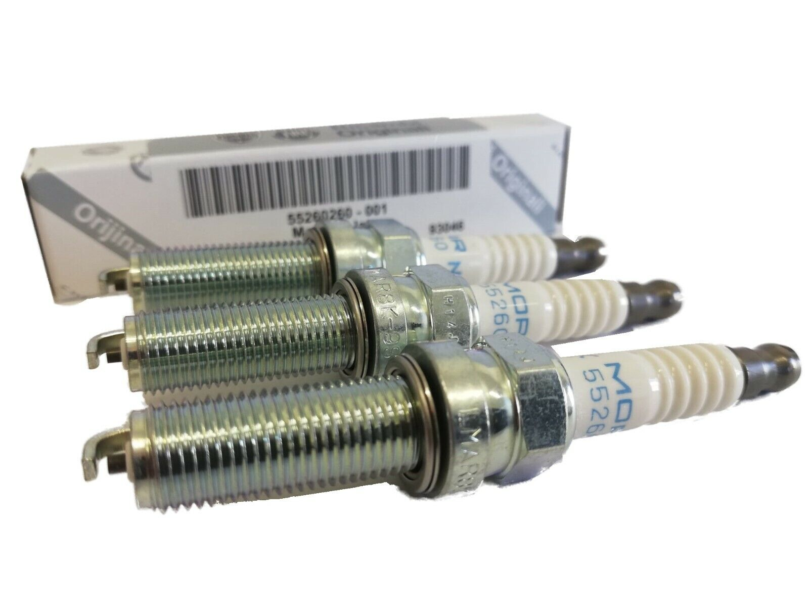

I'm having the most trouble finding the correct wrench size for replacing the spark plugs. Based on what's in the manual of the car, I need the following plugs:
NGK LMAR8K-9S (https://www.ebay.co.uk/p/24045086925)
I've tried to find the correct size using the following chart, but de name of the plug doesn't really seem to correspond with the letters in the table.
Anyone who could help?
Spark plug sockets are governed by their thread diameter, 14, 16 and 18mm. Other references are to the actual socket diameter.
That plug looks like a 14mm one, it could be a good idea to buy one with a rubber insert that grips the plug on removal, or better still, a magnetic one. As many plugs are deep down into a counterbored hole, a thin wall socket may be best.

Yep, 14mm hex on that plug.
I don't use a socket with a rubber insert as, sometimes the rubber stays on the plug, instead of staying in the socket. I just use a deep 14mm socket to slacken the plug until it is almost out then I undo the last threads with an old piece of servo hose.
To put the plug back in, insert it into the servo hose and thread it in. The hose will grip it tight enough to turn it but not tight enough to put it in on the wrong thread.
After loosening a plug that’s set deep in the head, I always use the actual plug lead to pull it out.
Thank you for confirming, plug replacement is what I'm stressing most about. I'll try the trick with the servo hose. Looks like there's a lot to replacing spark plugs. Will do some extra research before attempting it.
