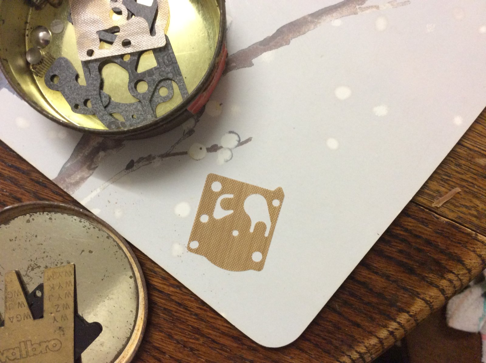

The kit I bought was from member K20 WAT or close to that and was listed for the walbro wt441

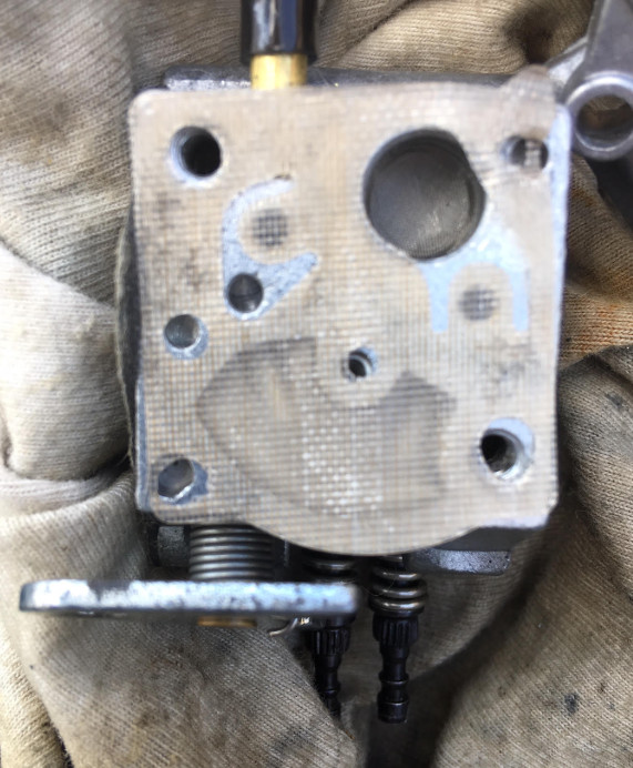

I'd compare the new diaphragm with the original one - if its exactly the same then its just the orientation we have to ascertain.
John :)
I assume we’re still talking about the brown mesh gasket. I see what you are saying so I will take care off again tomorrow.

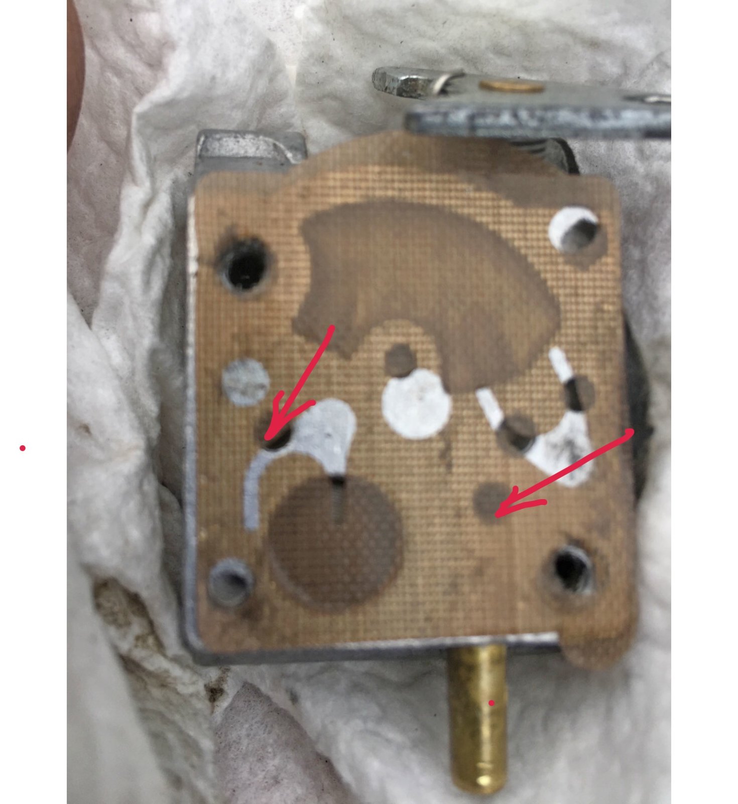

A8704DCB-E963-43B8-8720-AF5DC3C98D04.jpeg E2B9395D-C2AE-42B4-AFF3-058CD2447229.jpeg E2B9395D-C2AE-42B4-AFF3-058CD2447229.jpeg If you compare the brown mesh pump gasket in your #23 post you'll see its the same as as the one Ive just got from the Ws .I held my gasket over your latest pics an it lines up perfectly
so the one you discarded, by my reckoning is the correct one
Flap valves should line up with arrowed holes
Since putting this gasket on the correct way it feels better as ford pull it started.

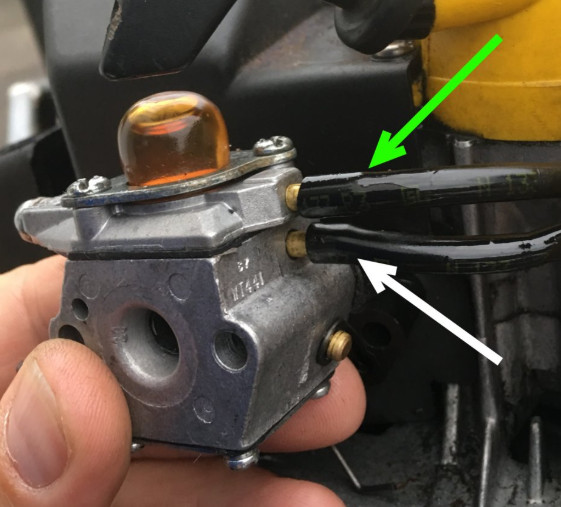

In one of my first posts i added this photo.
I mentioned that the top green arrowed pipe enters the tank & has a filter on it.
The white arrowed hose enters the tank & thats it.
Ive put mine back the other way around so now im doubting myself ???
With some fuel in the carb & both hoses off when i press the primer bulb i get fuel coming out of the top metal pipe.
This is why i thought it was a return
