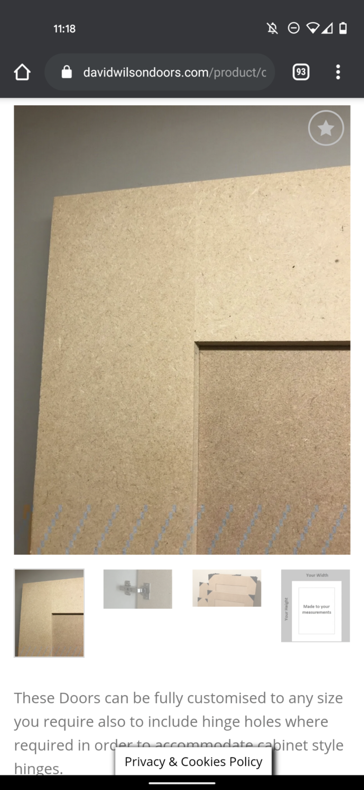

Having received some exorbitant quotes for panelled MDF doors from a few manufactures, I've decided to partially-build my own (for a walk-in-wardrobe).
I'm planning to buy some of the attached shaker-style doors (simply to save time), then add some beading onto the internal edges of each panel for decoration, and then glue a 4mm-thick mirror into each panel.
The 18mm doors will be thick enough to support euro-style hinges.
Anything else I need to consider or anything I've got glaringly wrong!?
I'd also like the chamfer the external edges. What's the best way of doing this with MDF?
Thanks!
I would add the beading AFTER the mirror, I used my local glazier to cut mirror for a similar project and it's very close, but not perfect.
The beading can hide any gaps. You'd need to calculate the combined depth of mirror/adhesive/beading before you order the doors.
That's a great point that I hadn't considered, and is obviously the way to go, however...
A 12mm back door panel, and 6mm shaker side panels, would leave an impossible 2mm for the beading, if we have to use a 4mm mirror
I'll have to reconsider sizing!
