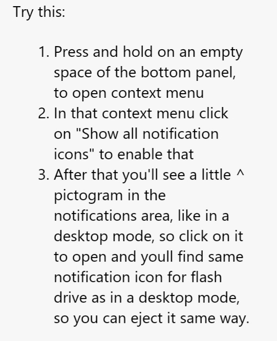

Unless I'm missing it, the tablet has no facility for doing that.
Ahh, had omitted to ask what OS the tablet was running.
If Win 10/11 in tablet mode...
If Android, slightly more involved (there may be easier ways!) - something like..
Settings>Battery and Device Care>Storage>Advanced and unmount the drive.
And ejecting/unmounting the device first, is still a good idea :)
