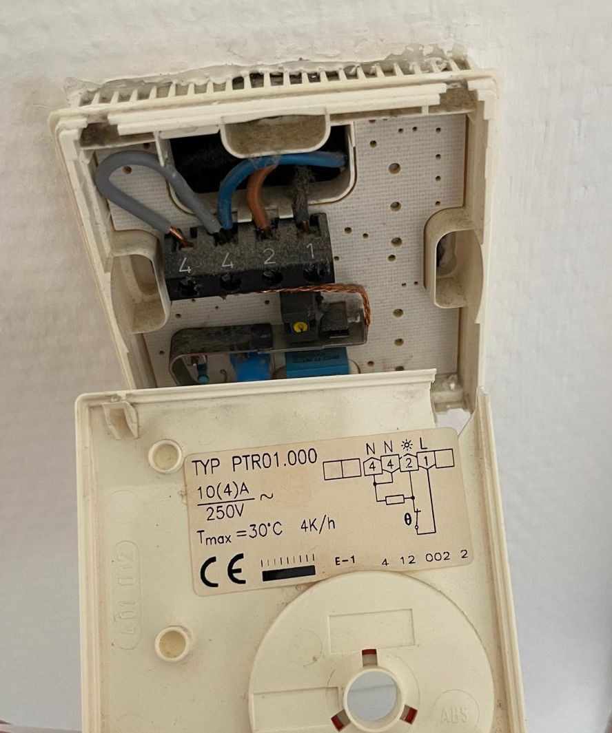

Hi all! I am trying to replace an old thermostat (Germany, underfloor heating, no boiler) where the casing chipped a bit with something a tad smarter and settled on the Meross MTS200. I'm stumped on the wiring though and reading all the other similar MTS200 threads didn't help me solve the problem.
I wired the thermostat as per the instructions on the Meross site, for what seemed like a texbook example. And for a brief moment it all looked fine except the actuator stays open no matter what - whether I set the temp above or below the room temp, or just set it to off. The thermostat looks like it's operating normally, I hear the relay as I play with the temp setting but the valve never closes. As far as I can tell the 2-wire actuator is NC, at least it's closed when I completely disconnect it from the power (and the electronics at the tip of the actuator are warm when the valve is open suggesting NC). I tried a spare actuator I found around the house and it has the same behavior. Before I play with the wiring more I'd love an opinion on what could be wrong.
On a different type of thermostat in the next room when some workers doing wall renovations dislodged it, the heating turned on (valve opened) and the previous owner just came, reseated the cables and it was fine again. This strange episode made me wonder why would a NC actuator open when it loses power, unless it didn't lose power, only COM? No idea, anyway, I attached a pic of the old wiring, maybe someone does have an idea what I could be doing wrong.
Can we have a picture of the rear of the Meross and how you have attempted to wire it? - there are multiple versions available.
Along with your actuators, the old thermostat is operating an N/C contact - try moving your switched live wire from N/O to N/C on the Meross, and see what happens.

If the wiring diagram of the original stat is correct, then the black wire should be L.
It doesn't mean that it is though.

That was also my thoughts, wants a small load, so a lamp would be a good idea to test with. The old thermostat did not "need" a neutral, the compensation resistor will reduce the difference between on/off if there is a neutral, but it will work without one.
The new thermostat needs the neutral to work.

So the measurements are as follows: Blue(N)-Black(L) 230V, Blue(N)-Brown(NC) 230V, Black(L)-Brown(NC) 0V. Between Blue(N) and NO (which is now not connected to any wire) I get ~4V. The way the wires are connected is mainly because this is how they were connected to the old thermostat, as opposed to Meross' example photo where brown is L.
What exactly should I measure to see if I have the "proper" neutral type?
So you have same reading Blue - Black as Blue - Brown, but no reference point. So we have no idea as to if blue is line or neutral, all we know is it is not same as brown and black.
We know if brown and black are connected together the heating runs.
So it would seem blue is neutral. But we have no idea if permeant line is black or brown, and it seems strange with all wires safely in a connection block to test, that both black and brown show as 230 to blue.
I would have assumed blue was neutral and if it did not work with black as line in and brown line out, I would have tried swapping them over, that is brown and black.
I would use a non contact voltage tester or a neon screwdriver to work out which is line and which is neutral, but there are only two options, if neither works, some thing has been damaged.
