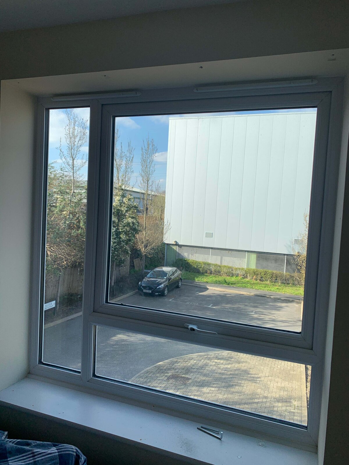

Hope someone can help. I live in a new build. Im trying to hang a custom sized blind in a window recess, but upon drilling holes, there seems to be metal running the full length of the window just after the plasterboard. It's about 20mm in, so I can't use any anchor style fixings. Theres barely 5mm between the plaster board and the metal.
The blind weighs about 6kg.
How could I go about trying to hang this?

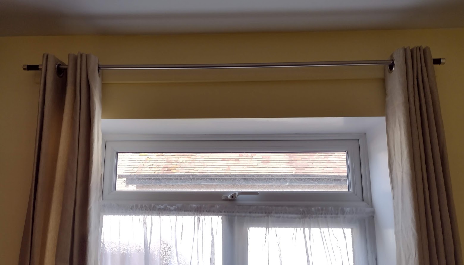

There used to be a curtain rod hanging in front of the window, but the kids pulled that one out, so that's why I'm going the recess route with blinds this time.

Steel drill bit and self tapping screws. It's a steel lintel.
Oh..I see. Thought the metal was maybe protecting some electric cables or something, but you're probably right. Also thought lintels were always wood or concrete.
Alright, this is officially beyond my DIY level. I think I'll call in professionals. Just to hang a blind :mad::mad::mad::mad::mad:

I can actually order side mountings from the blind company, but I'm concerned about the width of the blind. It's about 560mm wide.

Yeah, I thought about doing something like that, but because the blind was made to custom measurement, its so tight a fit in the recess. There's barely few millimetres gap on the sides. In hindsight I should have given it a bit more room.
I've stuck a strip of wood to the wall with no more nails and hung a curtain on that. Painted same colour as wall. If sticking to the top of the reveal you could also pop in a couple of small brackets just for peace of mind, although good glue can hold 5kg
Can your brackets not be used for rear mounting and then put the blinds in front of the goal post?
Hi all,
Just wanted to update. Finally Got the curtain hanging. Used Gripit’s.
Thanks for all the ideas.
