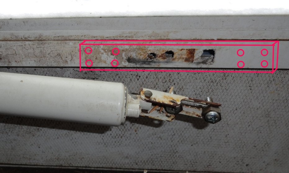

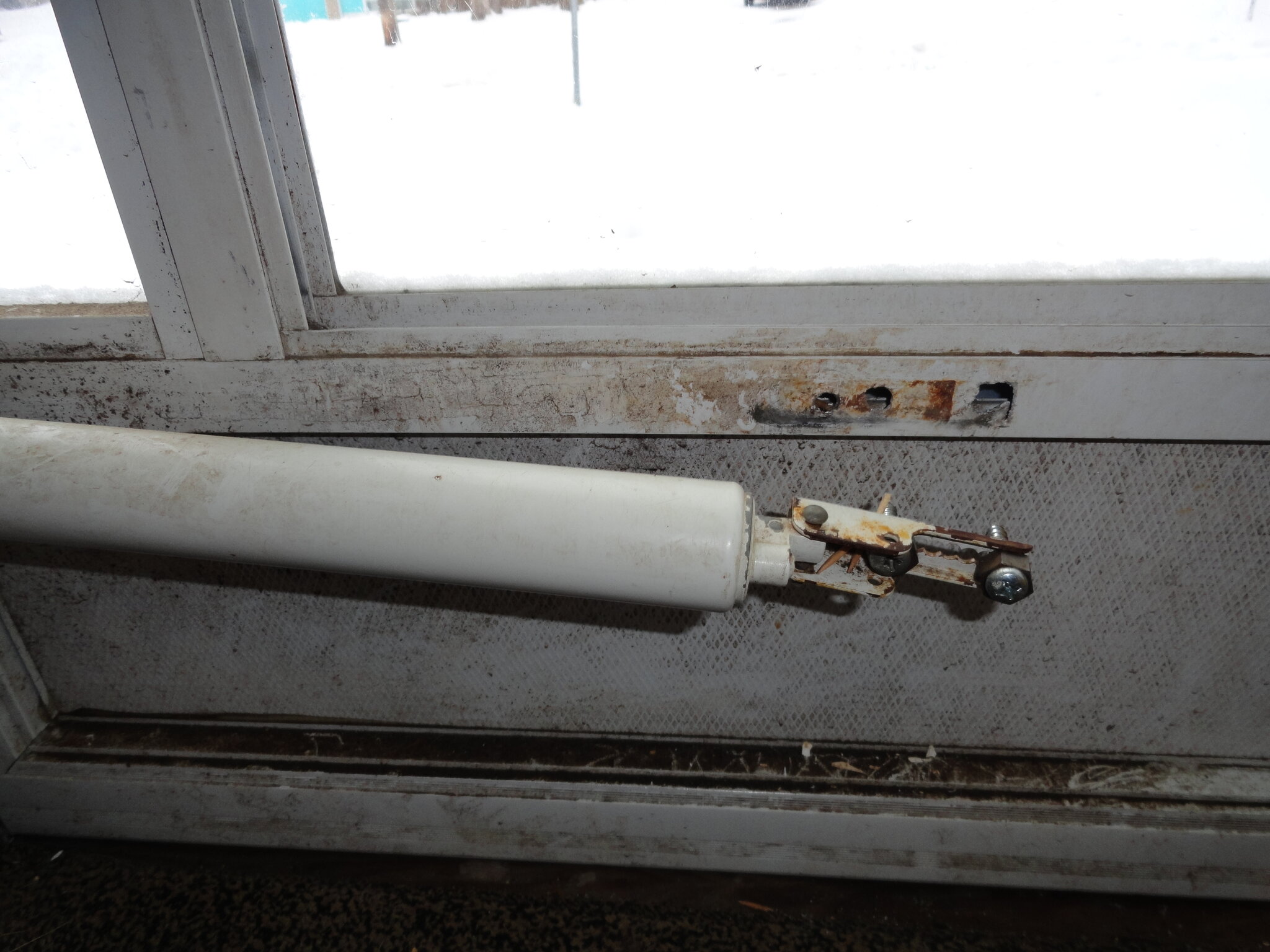

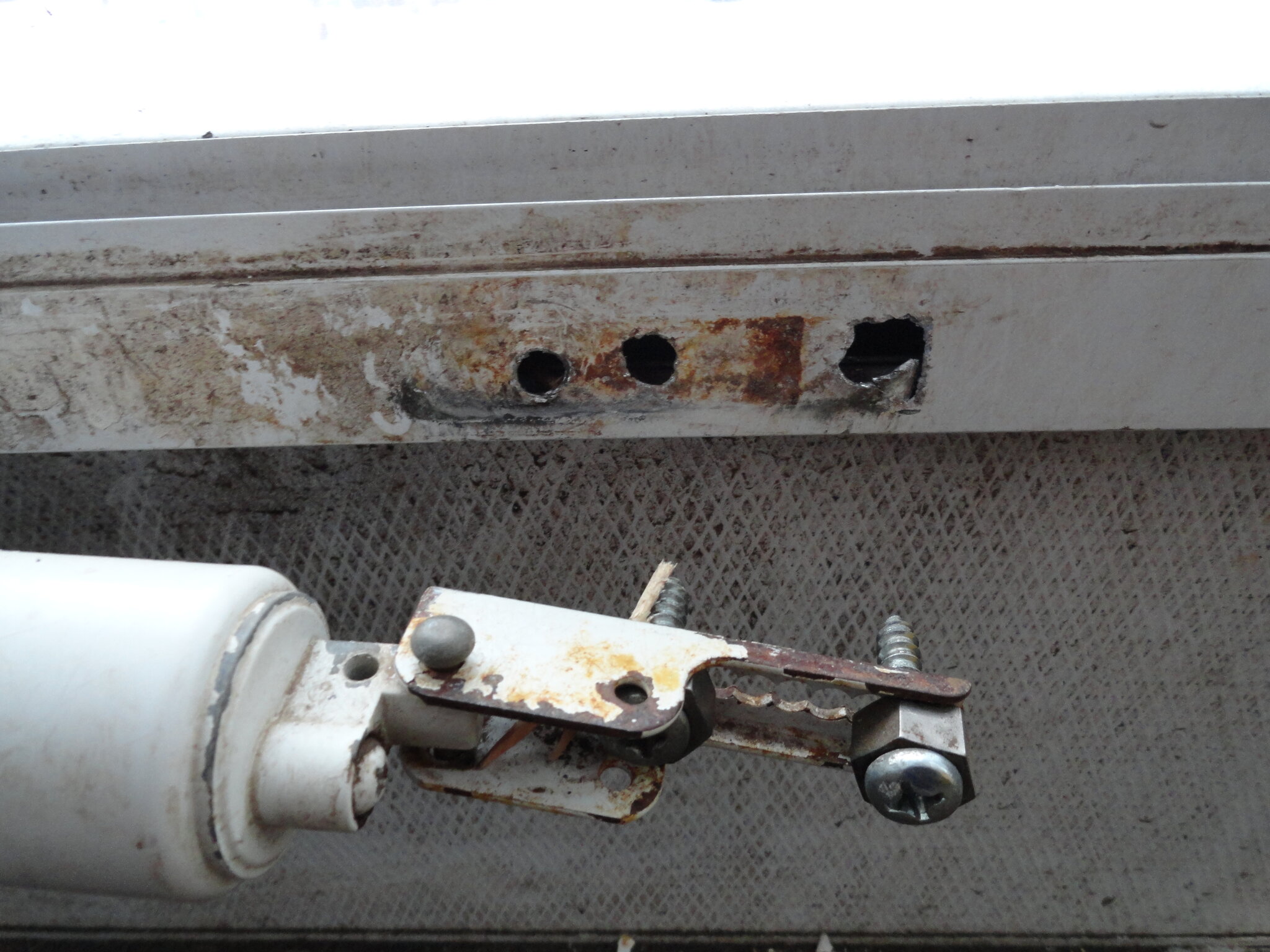

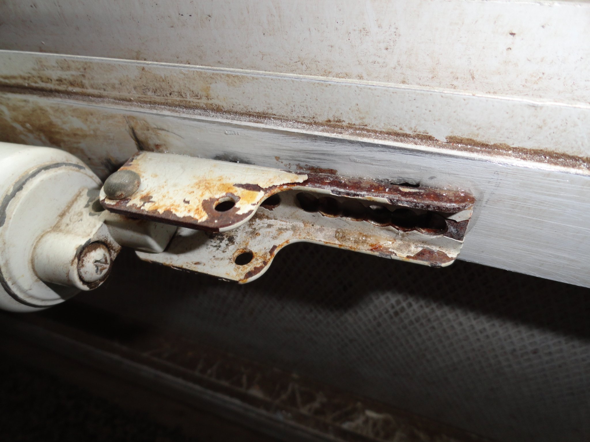

The closer on my metal storm door has pulled away from the holes where the screws went into the metal part of the door.
I have tried using larger screws but this soon pulled out of the holes as well.
Any thoughts?
Thank-you.
I do not have a rivet gun.
But if I had one, can I rivet through this area without access to the back?
Thank-you.

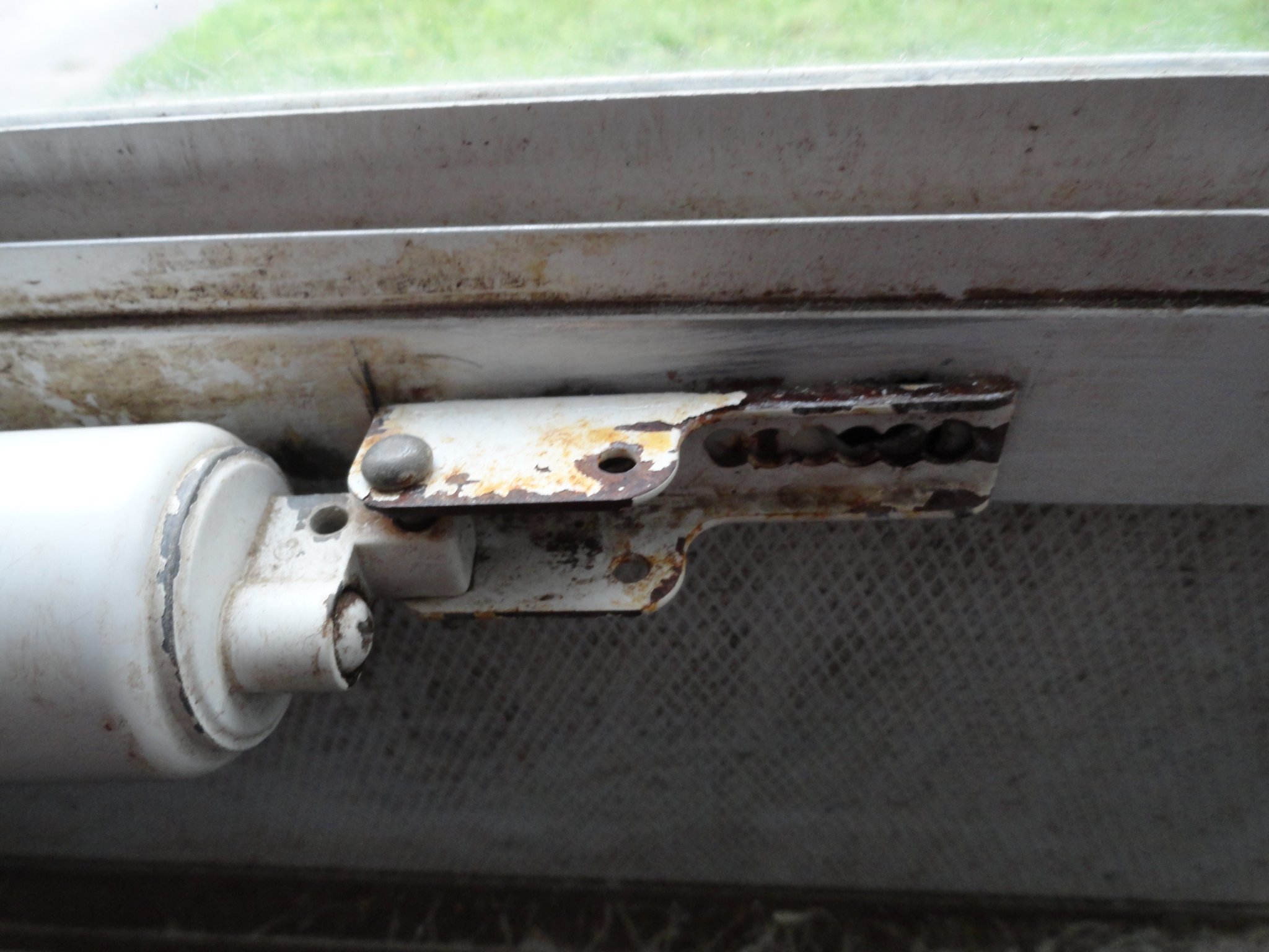

Well, to update...
I bought some Super Metal Glue and "glued" the storm door to the closer.
This repair has worked for almost 2 months.
I was very impressed with this product.
