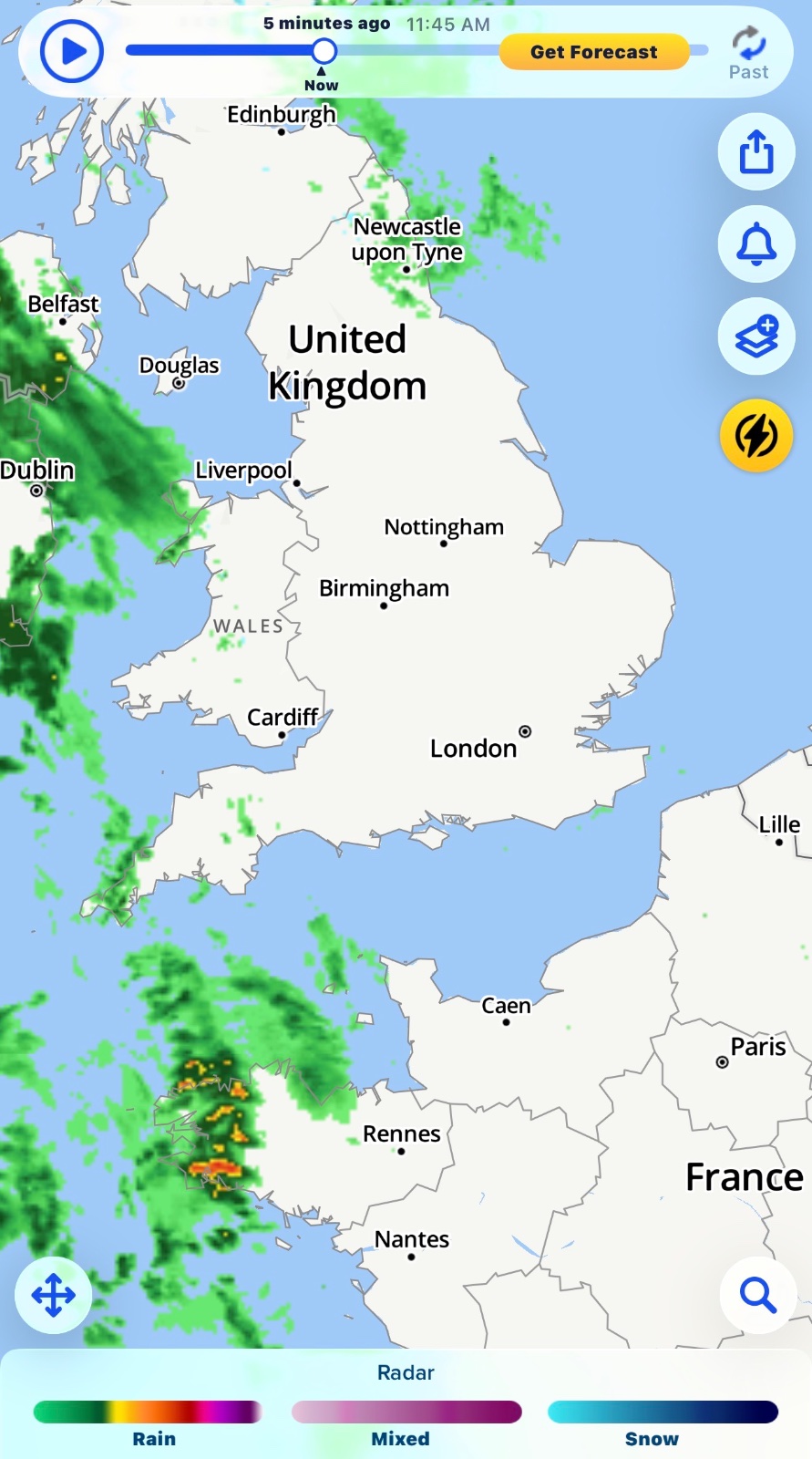

The key on your link says that it means the amount of precipitation, not the type. Are we looking at the same chart:
Generally its density. Most of the apps have a key
I recall from my radar course that it takes a bit of experience to detect snow as the radar shows it as a less dense object.

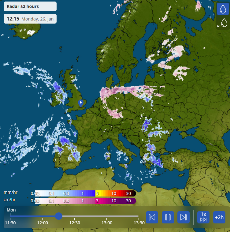

It's a bit confusing because the pink seems to be on the cm scale, which means it is heavier than the dark red or black on the mm scale.
Deeper layer, but not heavier, because snow is light and fluffy.
30cm of snow in a hour would be a lot, but not unheard of. 30cm or more in a night is common in some places.

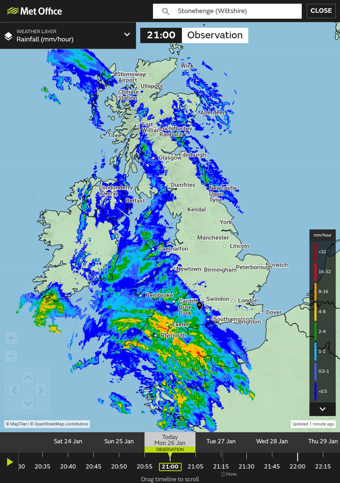

You can get good rain radar from the Met. Office site, but the cloud content is useless, it only shows vague forcasts, not actual, even for the past.
It does not show snow.
