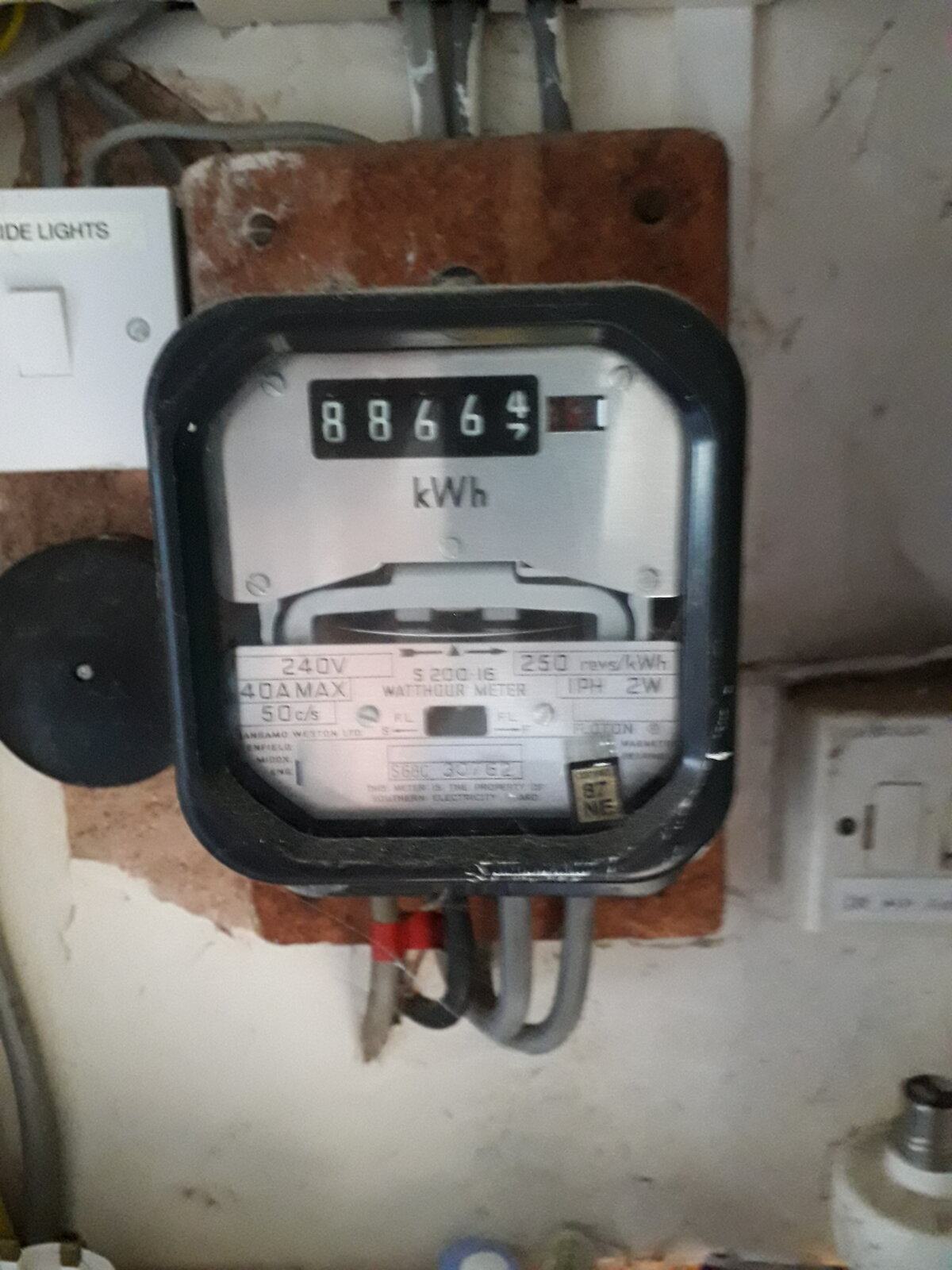

Our electricity usage seemed high - 4860 kWh per year for a 3 bedroom semi-detached house - so I started looking more closely at my meter. It's a Sangamo Weston S200.16. It has 5 white digits whose value is submitted as a reading, and two red digits to the right of these. The red digits might be expected to record tenths and hundreths of a unit, but they do not. The rightmost red digit records tenths of a unit, and the left hand red digit records units. The white units digit is in sync with the left hand red digit - for the most part. Both change slowly so that when a half unit is recorded, two digits can be seen - e.g. both 6 and 7 are in the window when 6.5 units have been consumed since zero.
When the red digits show 08, and the white units digit fully shows 9 (that is, 9 units have been consumed since it showed 0) , the white units digit jumps to 0. In other words, the white digits counts nine whole units from 0, then skips to 0. That is, the white digits count as follows,
xxx00, xxx01, xxx02 ..., xxx08, xxx10.
So for every 9 units consumed the meter adds an extra unit to the counter. We have had this meter unaltered for 17 years, and it must have been doing this all that time.
I have some ideas of what has happened, but I'd like your suggestions and thoughts,
1. Is there any way this meter could be recording usage correctly? The wheel revolution rate and tenths readings correctly reflect load wattage.
2. What is causing this behaviour?
3. Is it (a very peculiar) fault condition or has there been a modification. If so when and why would the modification have been made?

Surely if the meter starts at 00 and skips 09, that's still 10? Or am I misunderstanding something?
Good question.
Say the meter starts at xxx00. That right hand units digit gradually moves until it shows a 1 fully in the display - that is one unit consumed. Similarly xxx02 fully shown means two units consumed ... and xxx08 is fully shown when eight units have been consumed, and xxx09 is shown when nine units have been consumed. The issue is that when nine units have been consumed, and a nine is fully shown in the display, the meter skips to xxx10. So for nine units consumed, ten units are recorded.

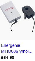

Yes, you can get CT coils to measure usage, like this 1729607995267.pngwhich with a hub connect to your PC. I have the 13 amp socket type, and this
does show how much my freezers used. But it is not as accurate as the meter, so it is only any good if the results are wildly different.

The meter is correct. You count 00 to 09 and then start again.
It does display digits 0 to 9 fully, but there is a twist. Transitions (0 to 1), (1 to 2), ..., (8 to 9) occur gradually with use, transition (9 to 0) is a jump immediately after 9 units are used. So it measures the use of 9 units, immediately displays 10 and keeps going. Then it goes (10 to 11), ... and so on.

That picture is not very clear or out of focus so I can't see the red digits at all.
Maybe you need an in focus time-lapse video of it counting up the digits consumed to demonstrate what you observe, as I'm confused by it all.
Your meter was last calibrated in 1987 and has a 25 year certificate. So that expired in 2012 and it is well overdue for replacement.
NB That exact model of meter is the subject of a You Tube video showing only one red digit which is moving the white digit from 2 to 3. See THIS
But then the same model number is used for the clock dial meter by the same maker so who knows how many variants exist :eek:
That is how that meter was designed. It's not defective, or reading incorrectly.
