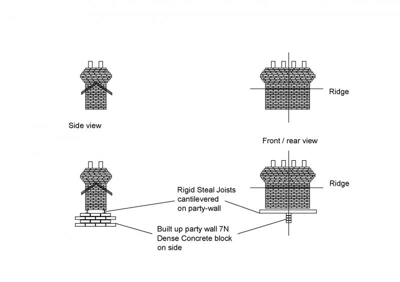

Hello I am considering removing the upstairs portion of a Chimney breast, it is shared with the neighbours who also want theirs removing, I thought about Gallows brackets but I don't think they will offer sufficient support to the remaining stack.
We both wish to keep the stack on the roof as it is a strong feature You can see a drawing I have done of the general idea.
Would very much appreciate comments.
