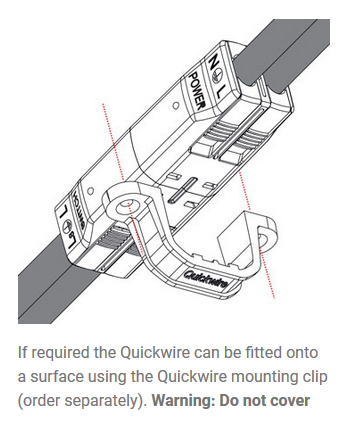

They appear to have no holes to allow them to be fixed to anything, and no cable clamps or restraints.
That does not seem a good combination.
Although they seem to think it is a beneficial feature:

There are also u brackets that allow you to secure the unit to a joist.

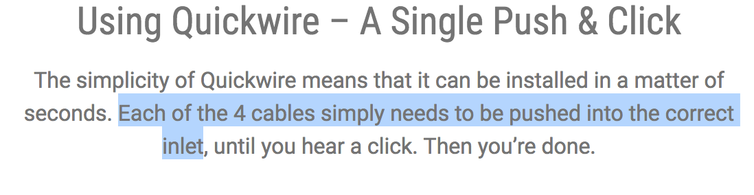

Can you really make make 4 connections in 7 seconds?

The info on the site doesn't make it clear that the device clamps the cable sheath.
But it's a fair cop re "They appear to have no holes to allow them to be fixed to anything".
