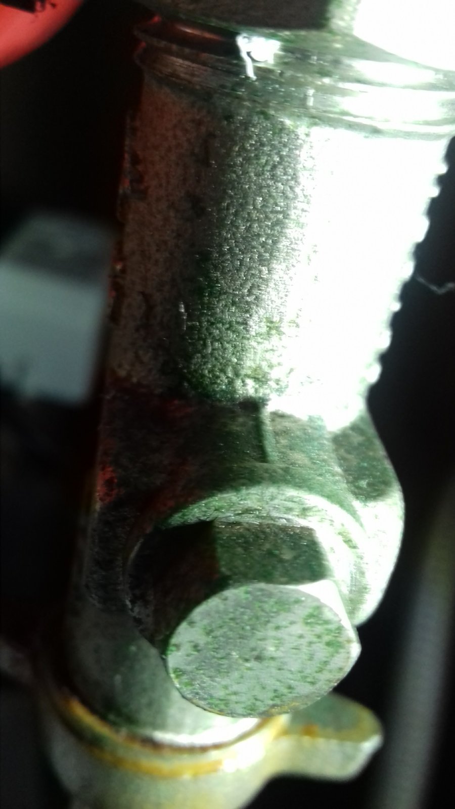

I looked at the pressure and it was 0
Spoke to my brother-in-law and he said , he used to often re pressurise for his mum - which seems strange.
So i added some pressure after getting the valve to open !!!!!!! as it was stuck
then bleed ALL the radiators.
Put the pressure up to 1bar and run the system
now they are all getting quite hot , except for one , which is hot at the top and warm at the bottom
check both the valves at the side of the radiator - not far from the micro-bore matrix
The pressure loop had 2 isolation valves and one was off - brother-in-law said he never touched that
it just has a Nut - so i have attached a photo - as i dont know how to tell how on/off it is

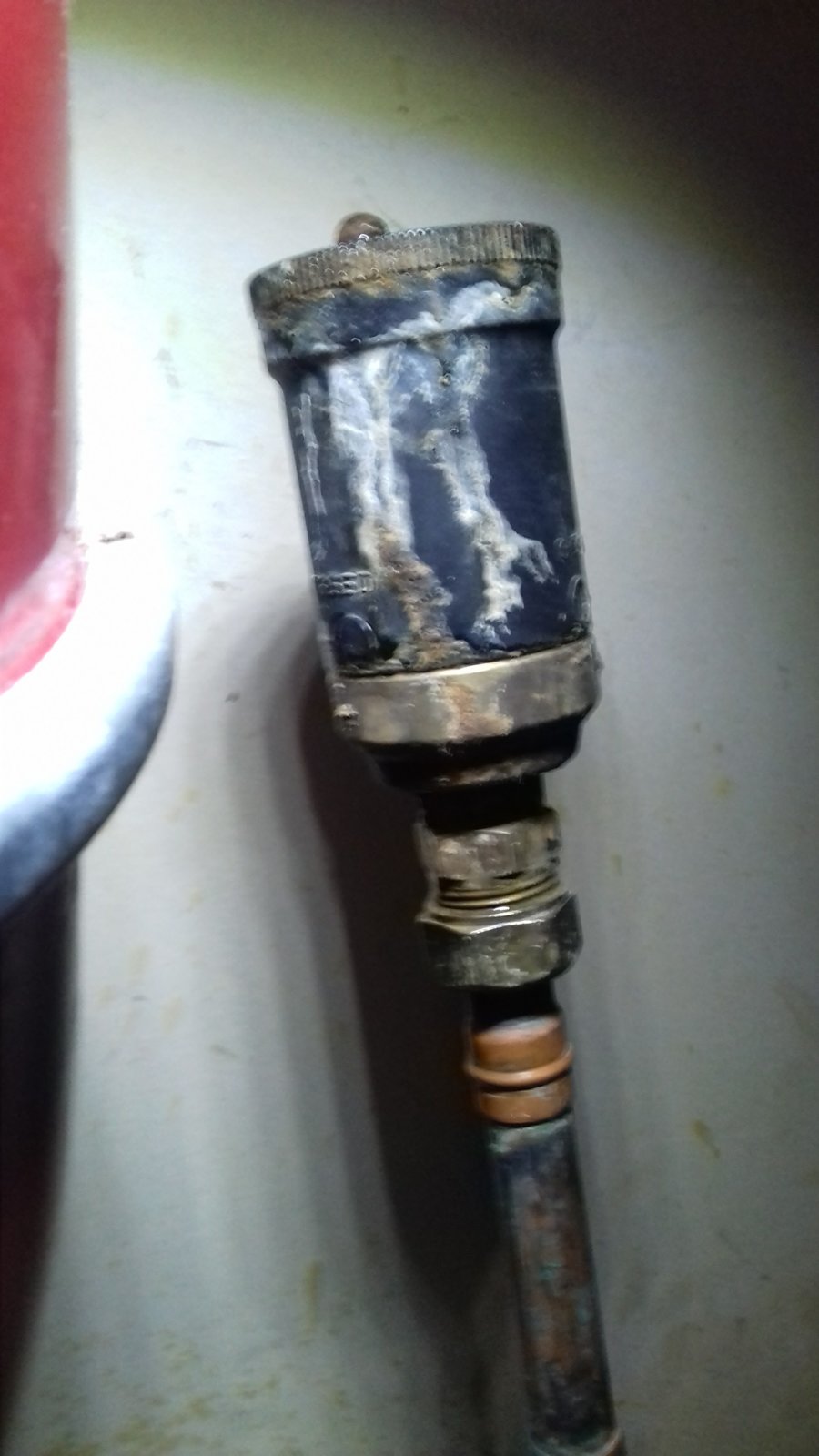

Also I found a small black cylinder and is that some form of filter is it a magnetic filter
I have also attached a photo
had a good look around, having to keep re-pressurising is not right , anyway - i found a very very slight leak - thats been there for ages.....
so arranged for a plumber to look at that , as its the soldered joints that are leaking , i dont have that kit
