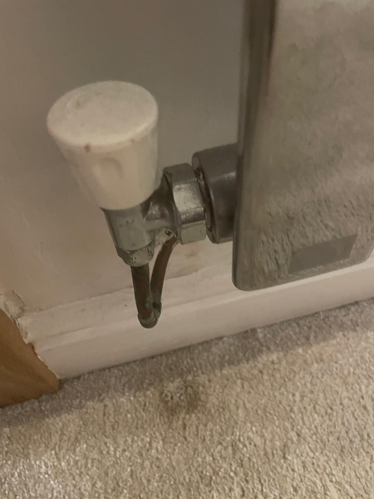

Would you try nipping this has a small leak. Have nipped before and have been ok and also had ones nipped and make worse.
so what bit nut is leaking and are you sure its not coming from under the cap
You need to remove the cap so you can have a good look at where the leak is coming from. If it is from the shaft, then the gland nut can be nipped up and that MAY stop the leak. If it doesn't then you probably need a new valve.
If the leak is from the valve connections to either the microbore or the radiator itself, then those joints can also be nipped up but, if you've done that before, then you may have run out of "nipping possibility"! Then the remedy is to drain the system, remove the valve and remake the joints but, if you're going to do that, you may as well replace the valve at the same time.
It's not been nipped before. It's just I have nipped a valve on microbore before where the pipe enters the valve and has made it worse once. Another time it was ok
Yes, I have had that as others probably have too. Luck of the draw really. You won't know just by looking at it.
I'd back it off half a turn first then nip it back up and see how it goes. Easy to crush 10mm copper and olives by overtightening IME.
