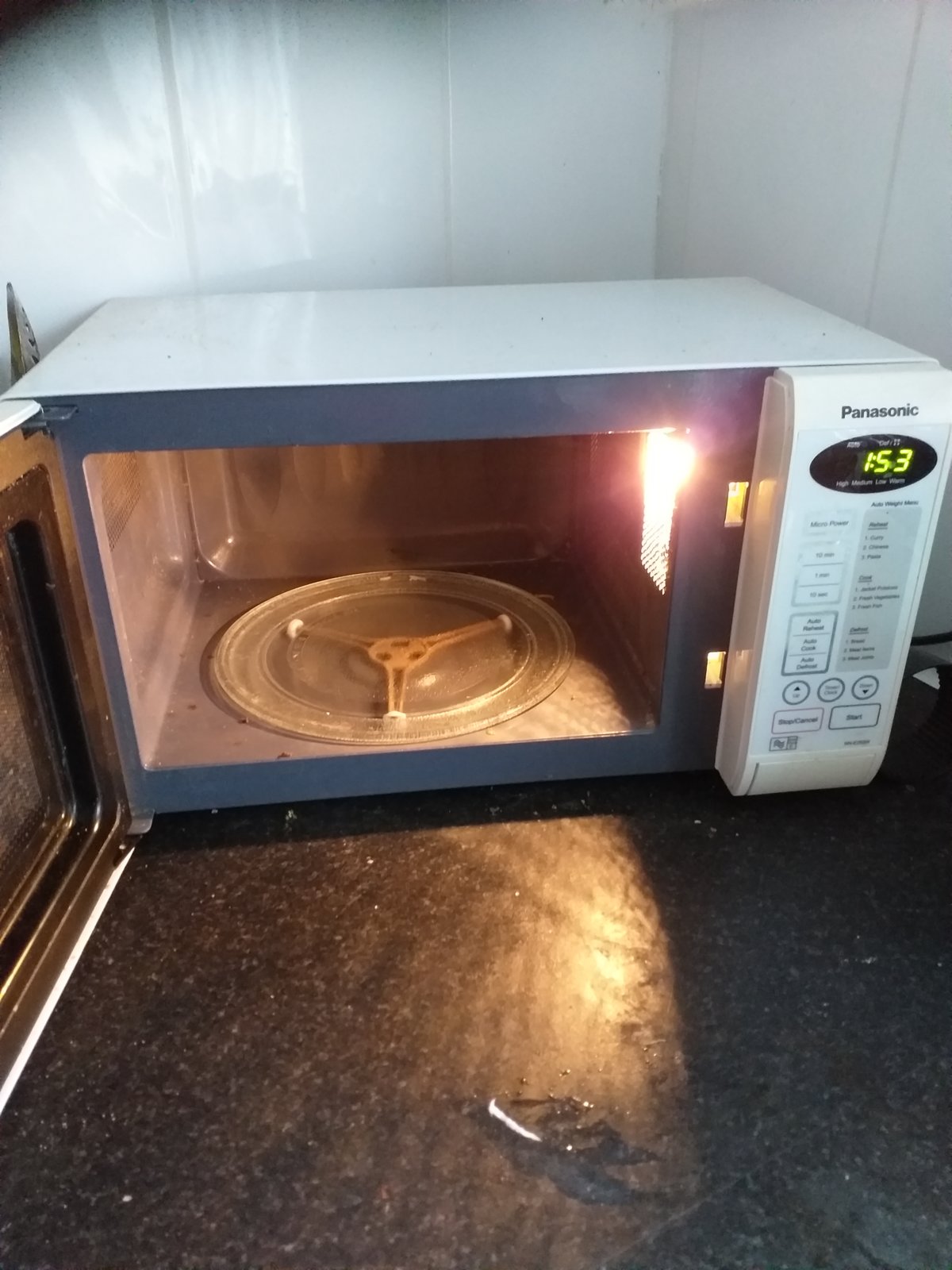

This microwave keeps making a spark noise. Has it had it?

The sparking in the microwave may be the little white coloured window which covers the wave guide exit. You can buy them for a pound or two, then cut to size with scissors.
