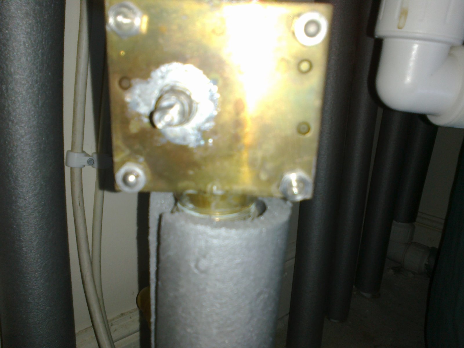

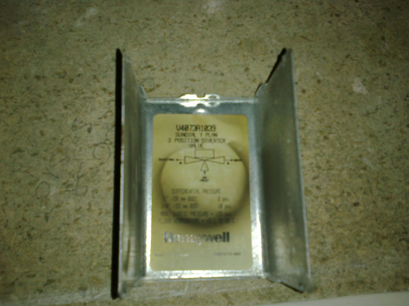

Following on from previous post where I am still getting HW when only CH is selected I was looking at the mid-position valve voltages and concluded the voltages in CH and HW were as expected so I have now got around to having a look at the power head and valve.
Firstly, I noticed the scorching on the power head lid. Is this normal? The synchron motor is quite hot to the touch

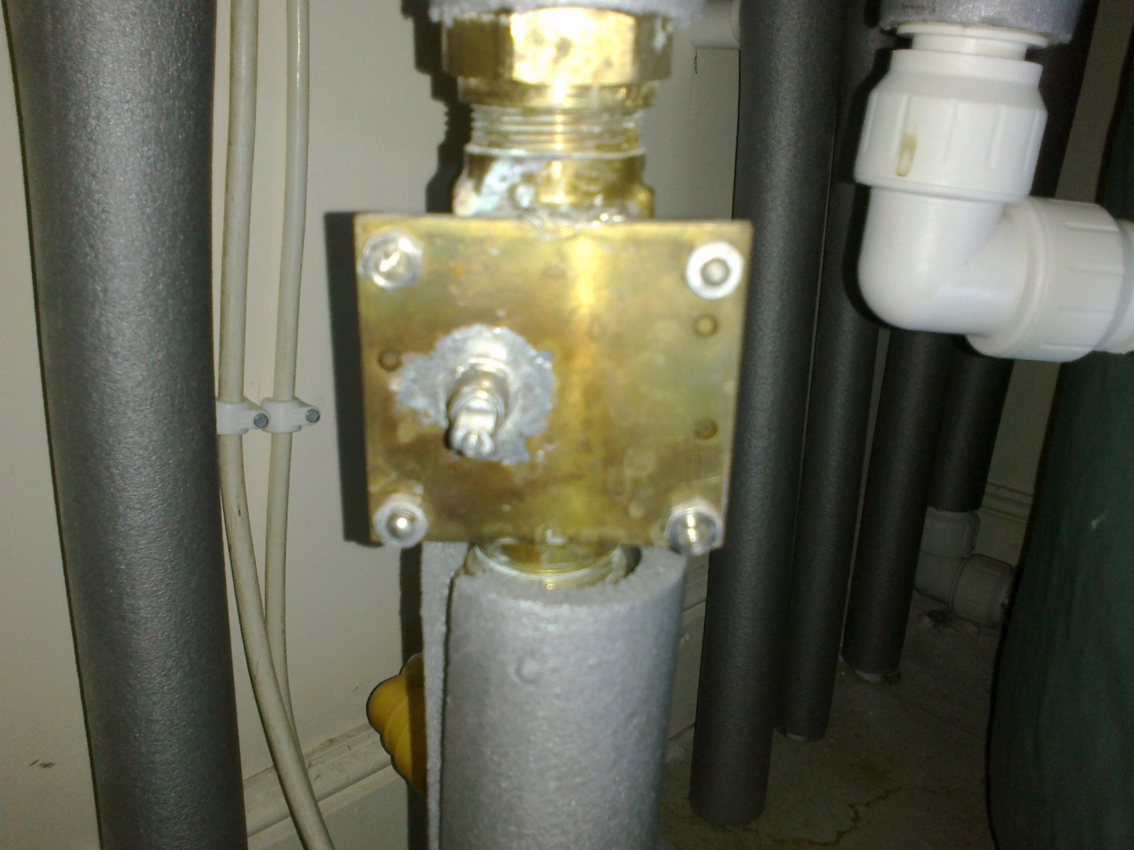

I then checked the movement of the valve. I understand that the spindle doesn't move far so does this look about right?
The feed comes in from behind the valve, with HW outlet to the top and CH to the bottom. I need to figure out which way the spindle needs to be rotated to get just CH
