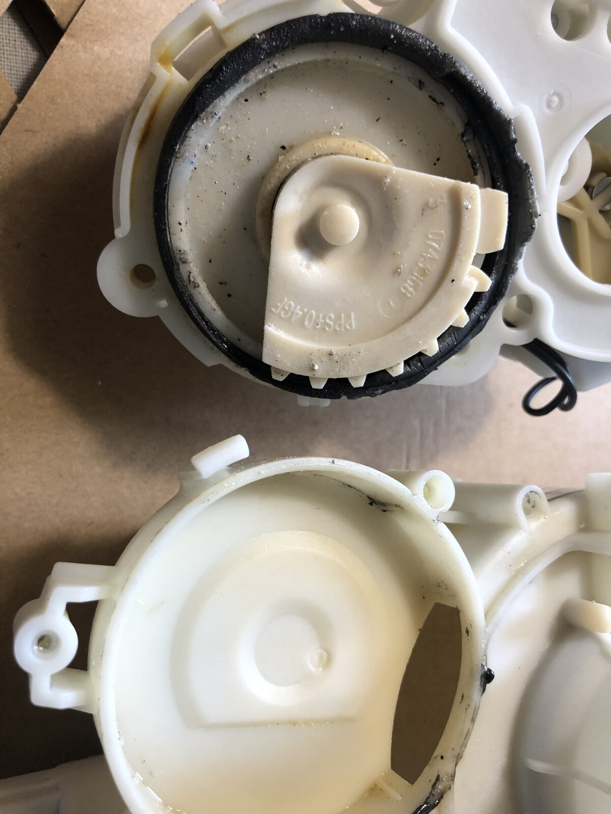

A seal on our Miele has gone causing it to leak…and in turn trip the float switch.
The seal is difficult to measure due to perishing but I think ID=50 or 51mm, OD around 55mm and height about 5mm.

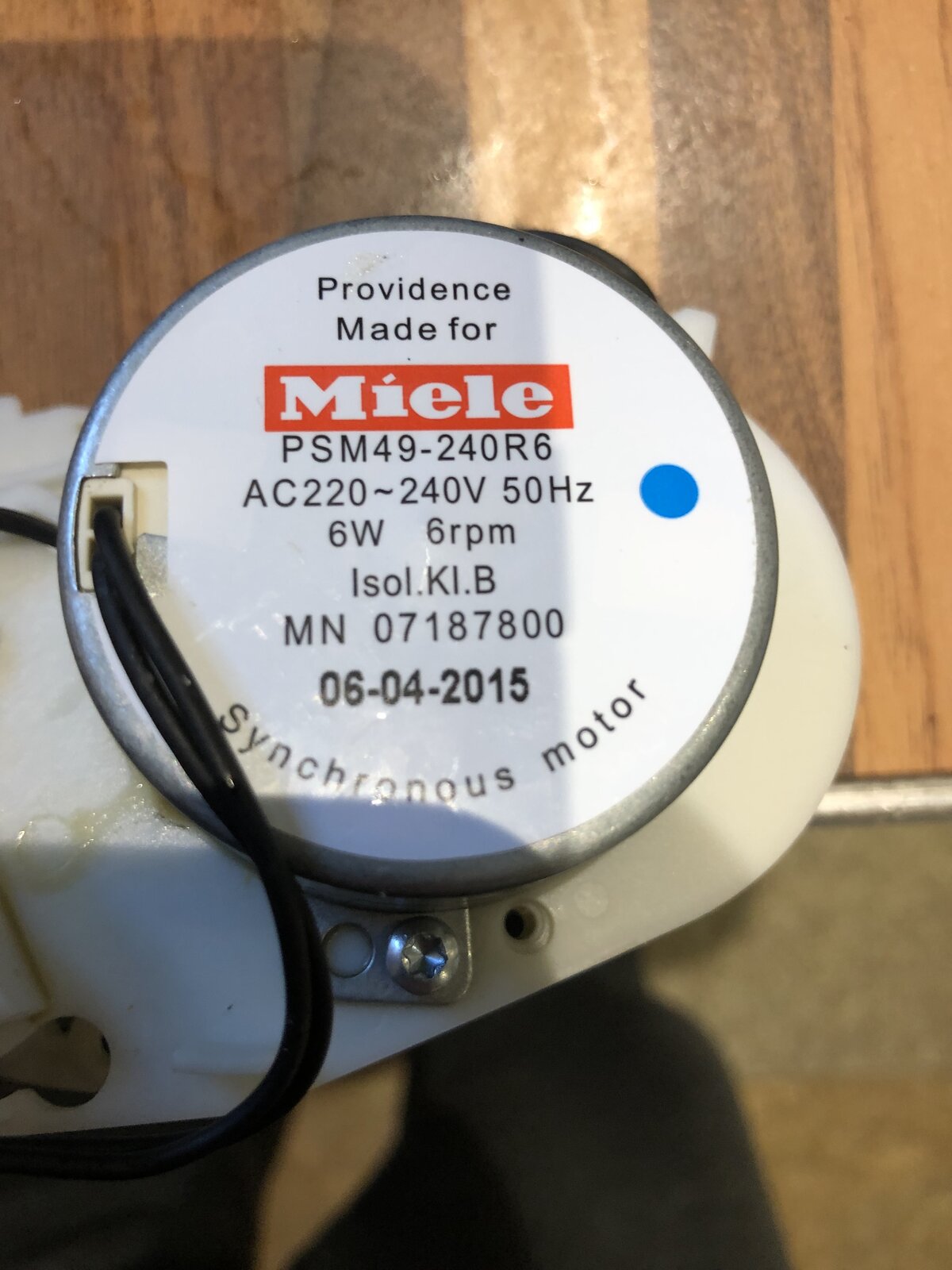

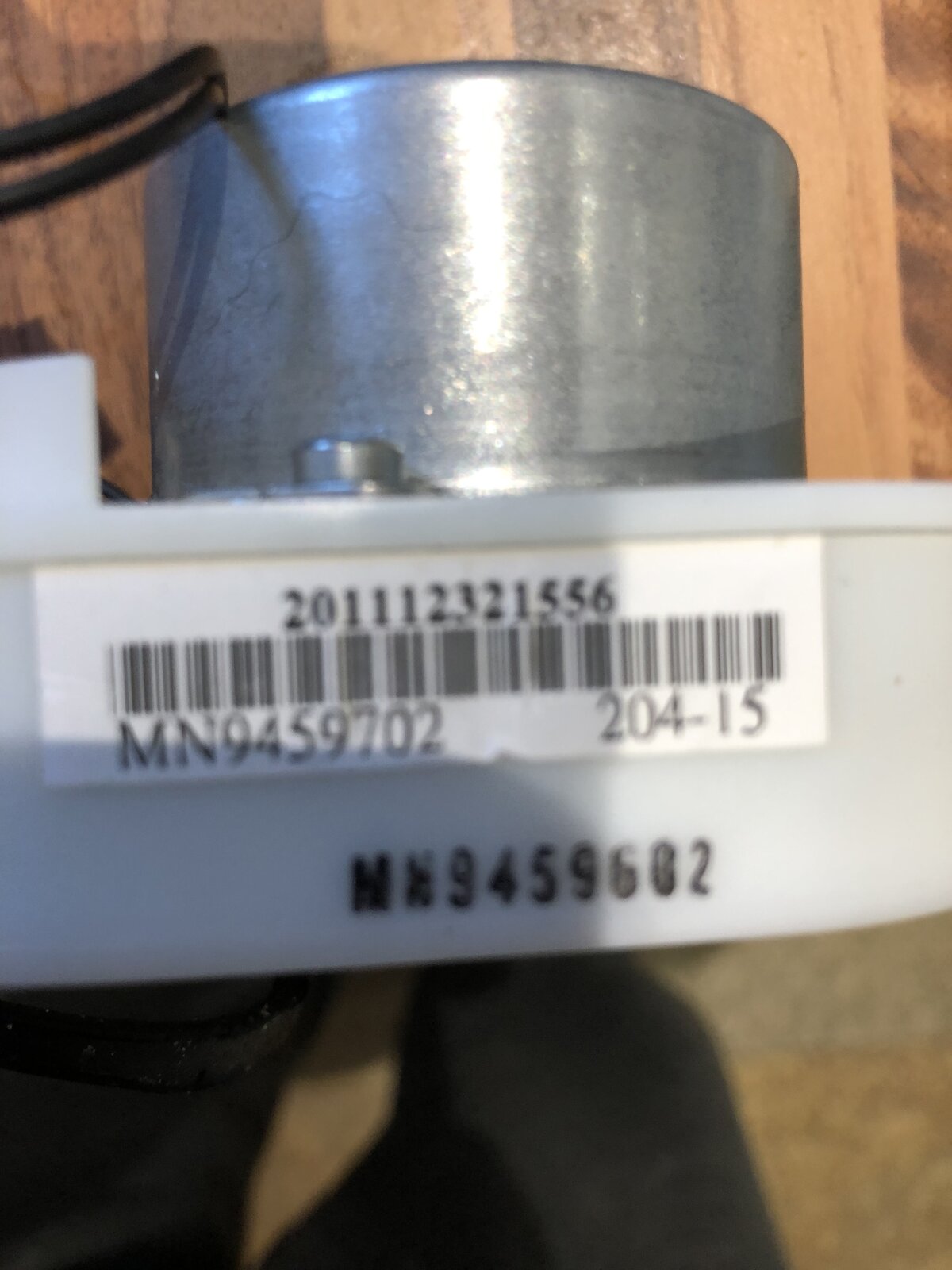

it seals the synchronous motor (no parts list number) to the main circulation pump (item 300).
Predictably Miele don’t provide a breakdown to that level so no part number is identified. Seal cost 50p - £5…..new pump £400
Does anyone know the correct dimensions so I can order something to fit?

50mm ID 2.5 CSA did not work…..a square/quad seal is required but finding one is proving a challenge
LuthersDad, did you figure this out? I need to replace exactly the same seal, and I'm having the same challenge finding the part.
Buy a length of viton square section seal material, of the correct dimensions, cut a length with accurately cut square faced ends, to match the diameter, then join the ends with a suitable superglue. It might need a few attempts, to get the precise diameter right, so start a big too big..
