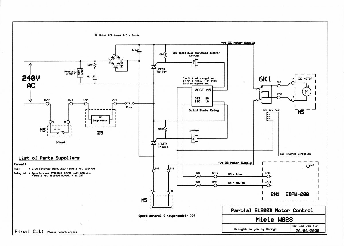

-Check if your TR5 fuse is broken. I assume this is universal for every EL200 models (mine is EL200-C, it reads in the heatsink in the board). Remove the board from the machine and check if there is resistance between the fuses leads. If the resistance is not zero the fuse is broken and you should change both TR5 and 6K1 relay. (BTW, the black tube which goes trough the board can just be pulled off. Took me a while to get the courage to pull it hard enough...). The two pictures attached are not from my machine but helped me to figure out what component is what. If I have understood correctly the 6K1 relay is the 'main' one meaning it wears the most. I would at least start replacing it (I didn't have to do anything else than replace TR5 and 6K1 to get my machine working again).

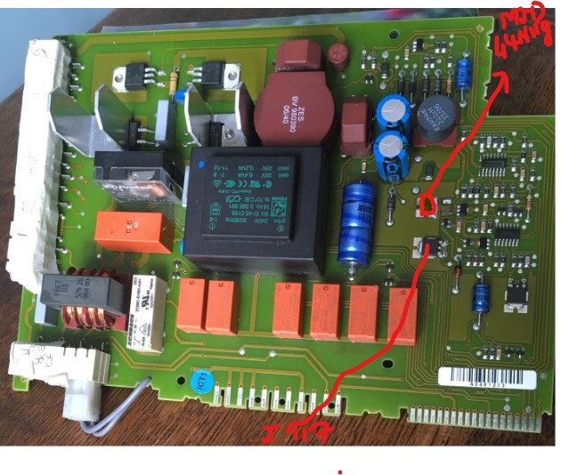

This week, miele washing machine drum would not spin in wash cycle(slow turns) but it has happy to spin in spin cycle(fast 1200rpm). So, took out the pcb and looked for any clues. To my surprise, a multimeter check showed
the transistor diodes (shown in the picture) were blown out. Do these transistors(MJD 44H11G, J117G) control the slow spin of the motor ?
I am going to replace these later this week and report back my experiences.

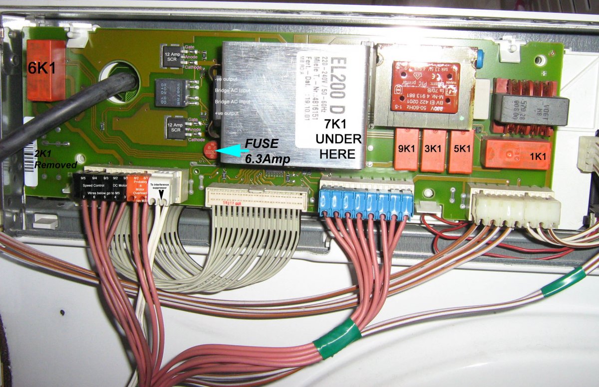

Just wanted to post here that we had the same issue with our Miele 842 washing machine, the motor stopped working and the rinse continuously flashed.
We went through this thread and the associated ones to identify the likely problem and a BIG thankyou to those who put in the work to explain all this...
We changed out the brushes first to see if that was the issue, the old ones had at least a 1/4in wear on them. That didn't solve the problem but im glad we did this as they needed doing.
We then went to the control board and replaced the motor relay (see photos) and the fuse... soldered on the new parts and everything works perfectly!!! especially as we fitted new shocks to the drum whist i was down there.
I have hopefully posted a few photos to help you see where the parts are...
The photo of the control board with the labels shows the motor relay and the fuse (the fuse is the little round black thing, the arrow is slightly off - sorry).

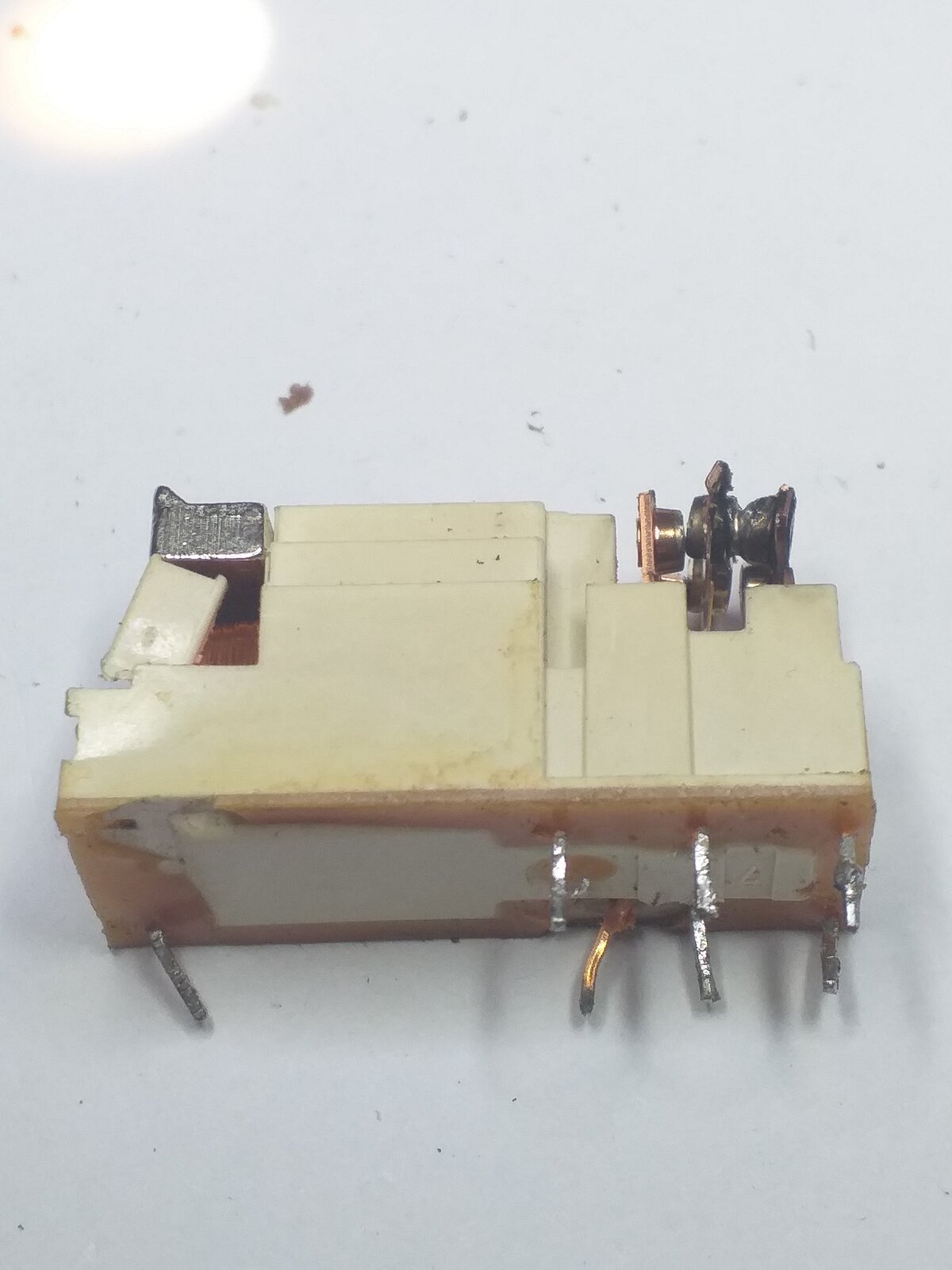

The photo of the relay shows the contacts were burnt out, i stripped back the orange plastic to have a look.
The fuse was blown, simple continuity test across the connections showed this.
I have added a couple of photos of the parts we ordered through RS but there are links above as well.
It was a faff, but alot cheaper than calling out an engineer and much better than see it go in the landfill.
Please dont ask me any technical questions... im good with the basics but by no means an expert on appliance repairs (just following others)
Good luck and remember.... REUSE - RECYCLE - REPAIR
Cheers
Mick
