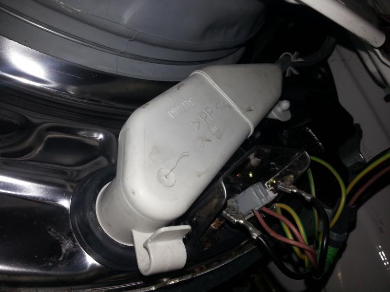

Ok, not sure which item is the Pressure Chamber so can you have a look at the image below to check if this is the unit you mean.
Also, if it is, any idea how to remove it ?

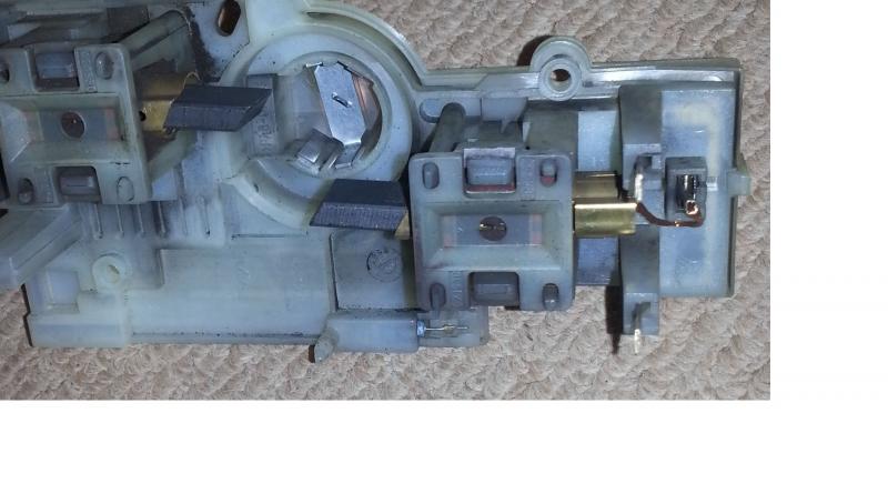

Also uploaded an image of the brushes for interest...
Think your at the wrong end of the hose but would be nice to know how clean it is inside that white block, follow up the pipe and see what it connects to, should be the pressure switch. Don't forget to check that the pipe is clear.
Brushes look good, presumably the carbon ends freely push in and spring load back out, don't push too far in or they may jam in.
Good continuity between carbon ends and contacts.
What does the motor rotor that fits between the brushes look? Good clean condition?
Oh, right that unit in the picture is at the bottom front of the drum, there is a narrow gauge rubber pipe that leaves that unit and goes right up to the top of the machine and actually passes through the hole on the EL200C board to a connector on the fascia...
The Carbon ends of the brushes push in freely and the motor rotor looks in good clean condition.
Looks like it is the pressure chamber, found these instructions on another site...
...The presssure chamber is connected to a small diameter black rubber tube which either goes to a electronic switch on the front board or to a mechanical pressure switch in the machine.
The chamber is located next to the heating element, middle bottom part of the front plate of the outer drum. It's an odd shaped white plastic container held in via a 8mm bolt and a seal.
Remove the bolt, grab hold of the chamber and give it a gentle pull. Once you have the chamber in your hand, you should be able to run water from the larger hole which was pushed into the seal in the drum so it runs out of the smaller hole which was attached to the small black rubber tube. If not it's blocked. Replace it or clean it out.

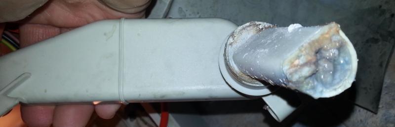

Right, well I decided to remove and clean all the obvious parts including the Pressure Chamber.

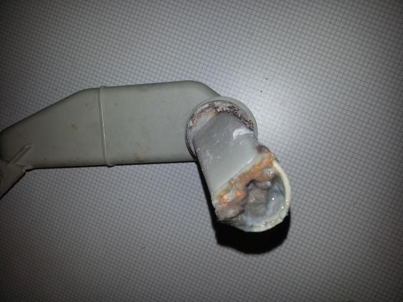

First was to remove the large black rubber tubing that takes the water from the powder compartments down to a white u-bend chamber that enters the drum. I also removed the white chamber itself by taking out the push in white clip and pulling the plastic unit out of its rubber housing. This was heavily calked up and needed a good clean with viakal.
Next was to remove the pressure chamber , again just one white plastic push clip and then pull out the chamber from its rubber grommet in the locating hole in the drum. The other end of the pressure chamber has a small rubber tube connected which has to be carefully prised off.
Immediately it could be seen the large hole was in a bit of a state see images below. I then took it away for a good viakal cleaning.

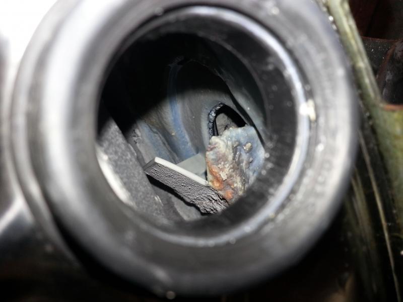

For some weird reason I couldn't help taking a picture straight through the pressure chamber location hole into the drum. God knows what that image has picked up there but its an interesting view.

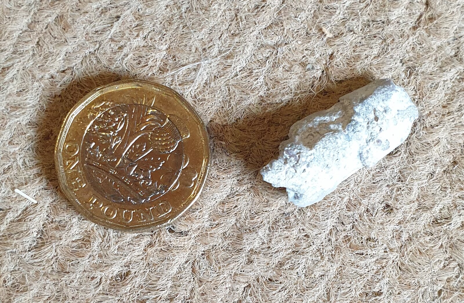

Had to manually drain the water out of the full machine using the pipe outlet by the filter. 16 pyrex dishes full of water later I could finally remove the filter and check inside the housing. Nothing obvious until I pushed my fingers right inside up against the impellor and found a foreign lump of calcium wedged in the blades (see offending lump below).
All cleaned out, filter re-fitted, press start and the W844 is performing again in it's own inimitable way.
