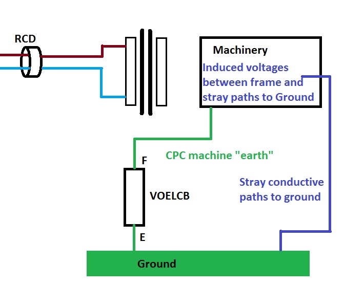

Given the use of an invertor then something along these lines is probably happening,
The transformer / inverter between mains via RCD and the machinery will prevent any Earth leakage affecting ( tripping ) the RCD
Given the use of an invertor then something along these lines is probably happening, ... The transformer / inverter between mains via RCD and the machinery will prevent any Earth leakage affecting ( tripping ) the RCD
OK, now that I've pointed out that leakage to earth through mains filter capacitors adequate to trip the VOELCB would almost certainly trip the 30 mA RCD, you've moved to a completely different hypothesised mechanism, which is fair enough. However, as I wrote ...
(in) the absence of earth leakage, the only voltage which should appear on earth wiring would be due to 'incidental coupling' (inductive/capacative), and that would be not enough to trip any device.
Do you really believe that the impedance of the path of "Induced voltages between frame and stray paths to ground" could possibly be enough to put ~250 mA through the VOELB coil?
Kind Regards, John
I do not think I have moved to a different mechanism.
All I can say is that it sounds very different to me. You were originally talking about 'leakage' to earth through mains filter capacitors, which would equally affect the RCD and VOELCB. You are now talking about induced voltages in circuitry which is isolated from the RCD.
Yes I do believe the induced voltages could be enough to operate the VOELCB
I'm very surprised by that statement. You seem to be implying that if the frame of the machine were not earthed, then touching it (and earth) could well have fatal consequences - if the 'induced voltages' could put 250mA through a 100Ω VOELCB coil, they could presumably put 50 mA through a "1kΩ human being". Is that what you believe?
Induced voltages can certainly result in 'tingles', but I've never heard of them producing significant shocks, let alone fatal ones.
Kind Regards, John
