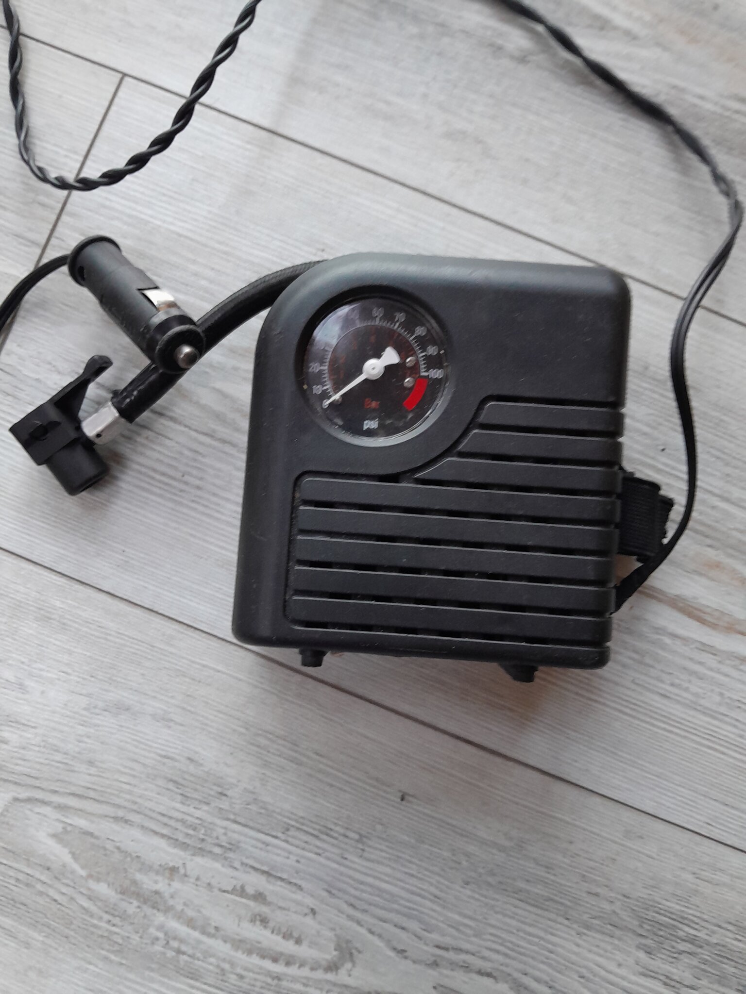

I have the possible previous model of this compressor, its a UMK 10 C2 that pulls a measured 7.6A when unloaded and almost 15A when compressing to 2.3bar BUT I power it from a old 7.5kWh House Alarm Battery and have never used the power points, I also have a Argos mini compressor for over 16 years which only pulls 4A unloaded and 6/6.5A when compressing to 2.2bar, I have used this from the car(s) power points occasionally but generally now use the UMK as it has a longer hose and is more convenient to use with the battery.

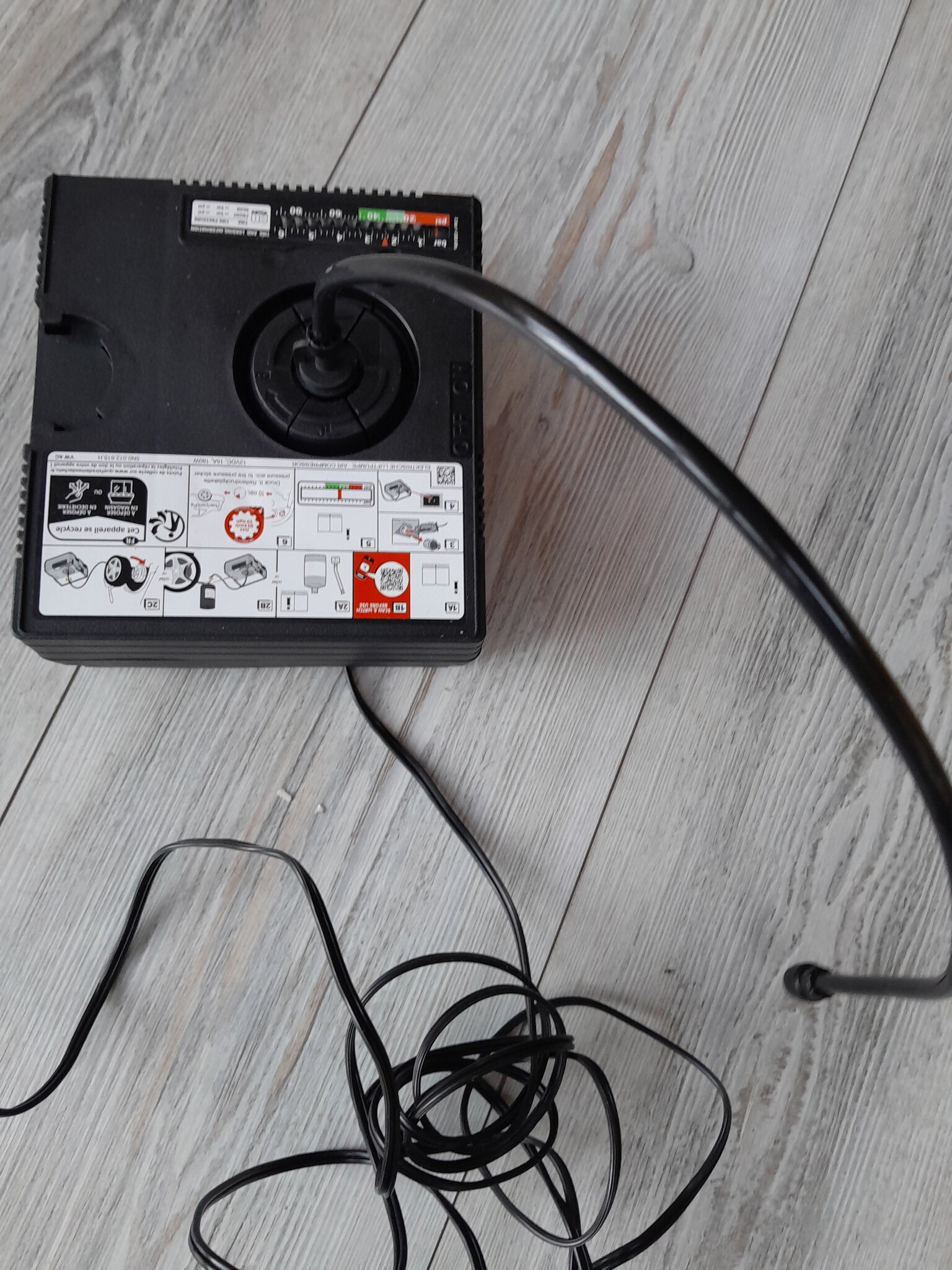

My Argos was cheap but gave/gives excellent service for topping up for years now on 3 or 4 family cars +various neighbours, the £28,000 (or so) one that came with my 2026 Polo has a hose that is literally and disgracefully, made of plastic and is so fragile that I just keep it in a bag with the compressor as no way could you wrap it up in its original form as it would kink and probably break in a very short time, also, unlike any mini compressor that I've ever seen, it doesn't have a glass (quick blowing?) fuse in the end of the plug, even the Argos has one + a real braided hose.
