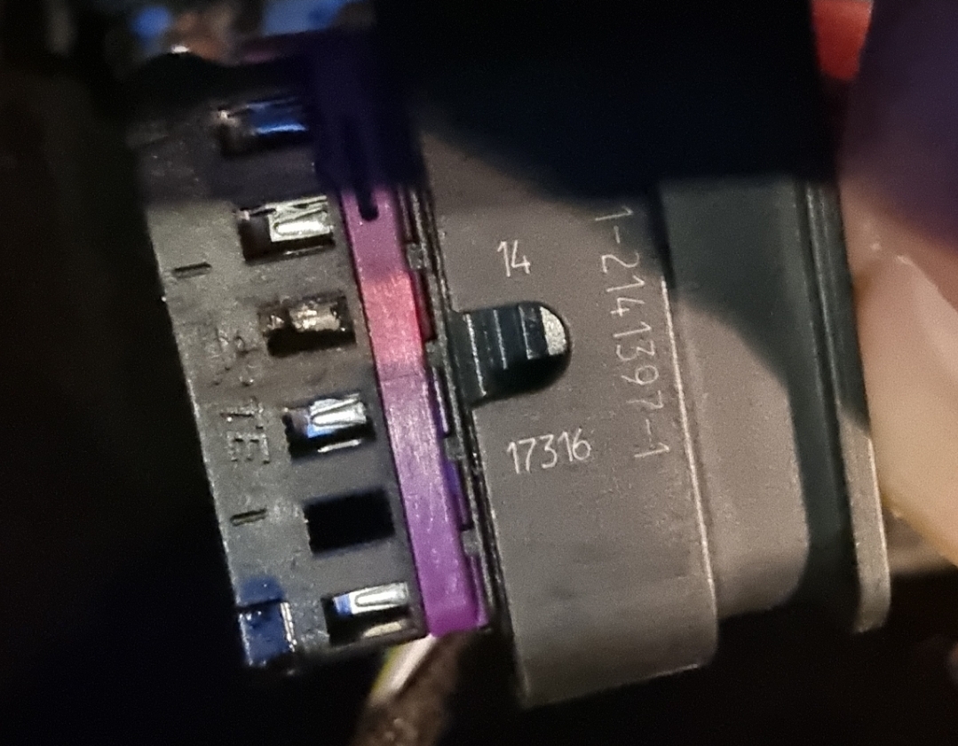

Wife forced into a flooded road a while ago and the rear offside light cluster (brake, indicator and reverse lights) stopped working.
Took the assembly out and it was soaked. Dried it all off and it works. Now it intermittently stops working.
Took a look and the middle pin of the connector has corroded / melted via a short.
I can ebay a new assembly cheaply although cannot find where to get the connector from. Found the datasheet.
1-2141397-1
Datasheet from arrow
Can anyone assist? Is there a generic part or even official one you can find a link for?
Found the BMW generic part (I think), coming Thurs. Found plenty from China but cannot wait a month.
Have a look on realoem.com, enter your vin and you'll find diagrams for your specific model.
Most bmw connectors and pins are available from a main dealer there just a bit awkward to find the part no in realoem.
