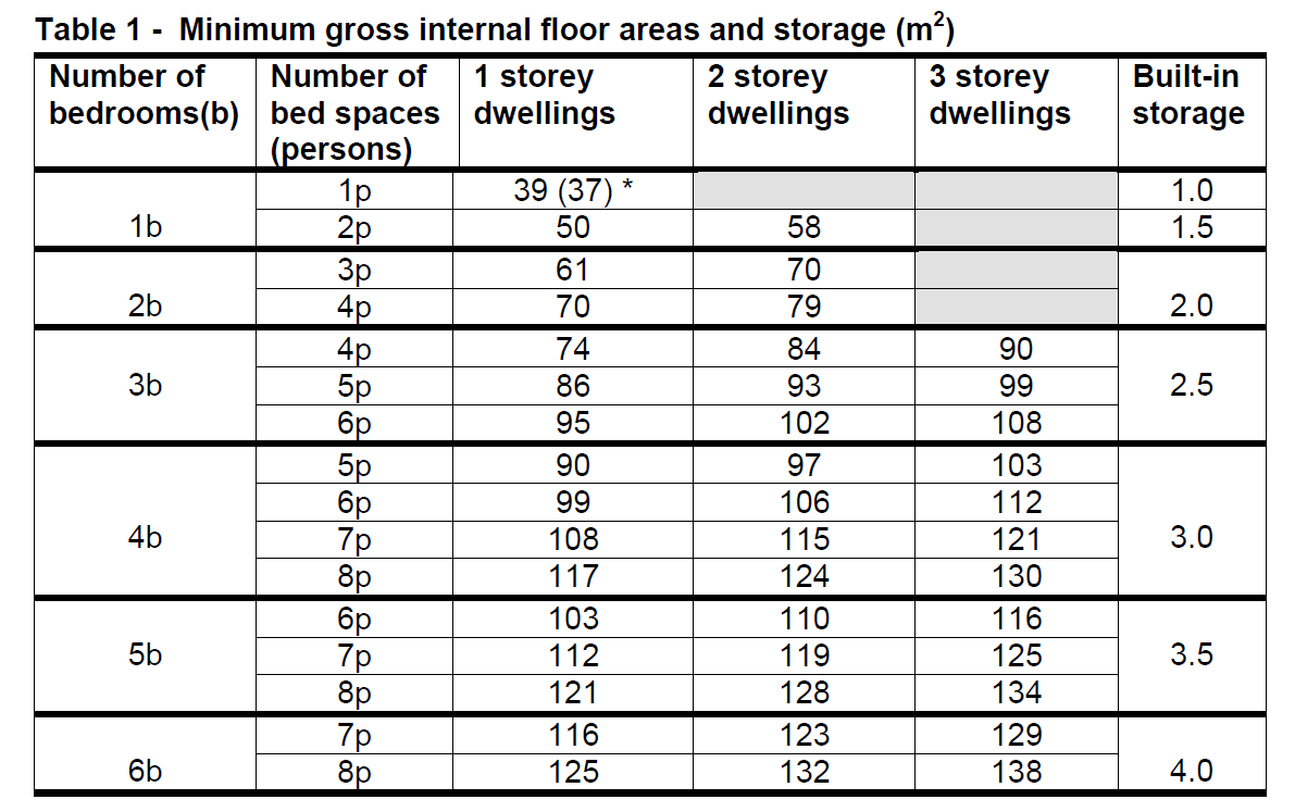

    I've noticed some very small flats that are being built near me. These are the planning application drawings and this is the planning application. The application has been granted so presumably this is all legal, but I'm astonished at how small they are. 3 of them are 18.6sqm and walking past them they look more like shed size than livable space.
    I found something saying that minimum space requirements are 39sqm, but this has been dropped in London so there are different rules.

    Space standards for student rooms are smaller because it is accepted that the students will not spend long periods in their rooms, and they are only occupied during term time.
    Nationally described space standards for dwellings: cap space standards.PNG

    This application was made under Government's permitted development rights which circumvent most planning requirements including space standards.
    This may change at some point as Gov are reviewing PD rights for residential units after a number of schemes which included horrendous units made it into the press- conversions from office which included flats which have no windows, tiny units etc.

    I think this one was a tipping point-
    https://www.theplanner.co.uk/decisi...o-windows-allowed-under-permitted-development
    Appeal: Flats with no windows allowed under permitted development
    An inspector has approved plans to convert an industrial building in Watford into 15 bedsits, seven of which would have no windows, ruling that the scheme met the requirements of the GPDO.
    The appeal concerned an industrial building in Watford that was last in use as an upholstery workshop. The building is single-storey, with a high dual-pitched roof. It has a mezzanine level, but no roof insulation.The building has only small, high-level windows at ground-floor level.
    The appellant sought permission to convert the building into 15 studio flats/bedsits under schedule 2, part 3, class PA of the general permitted development order, which allows changes of use from use class B1(c) (industrial) to residential.
    The flats would each have an area of between 16.5 and 21 square metres, less than half the minimum standard for a 1-bed flat, which is 37sq m. All of the upstairs flats and one downstairs would not have any windows.
    The council refused permission on the grounds that the quality of the accommodation proposed was so poor that the units could not be considered “dwellings”, and therefore did not benefit from permitted development rights.
    The council officer’s report noted that the units “would not provide any meaningful outlook, daylight or even appropriate ventilation”, and that upper-floor units “would have no means of escape in case of fire”. This “oppressive environment” would have “a serious impact on the health of future occupiers”, it concluded.
    Inspector Steven Rennie acknowledged that the proposed units were small, and that “living without a window would not be a positive living environment”.
    However, he noted, “the provisions of the GPDO require the decision-maker to solely assess the impact of the proposed development in relation to the conditions given in paragraph PA.2”.
    “The size of individual dwellings to be formed by the change of use and whether they would have windows/ventilation is not a condition of the GPDO” for the change of use proposed, he concluded. On this basis the appeal was allowed.
