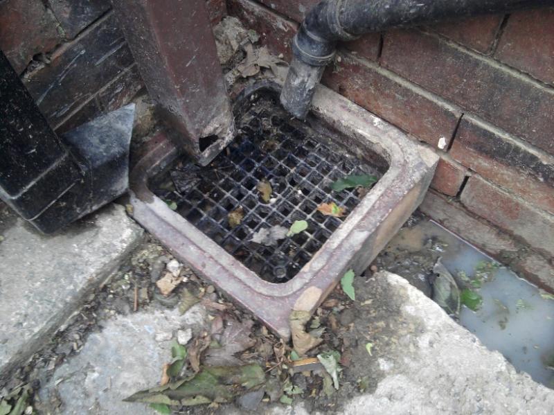

Hi there,
In the process of renovating the back garden which involves lifting the old driveway (runs the length of the side of the house) and re-laying it with new slabs. In doing so, I’ve come across a bit of an issue with the rear drainage. This grid takes a mixture of gutter rainwater, kitchen waste water and upstairs WC bath/sink waste water.

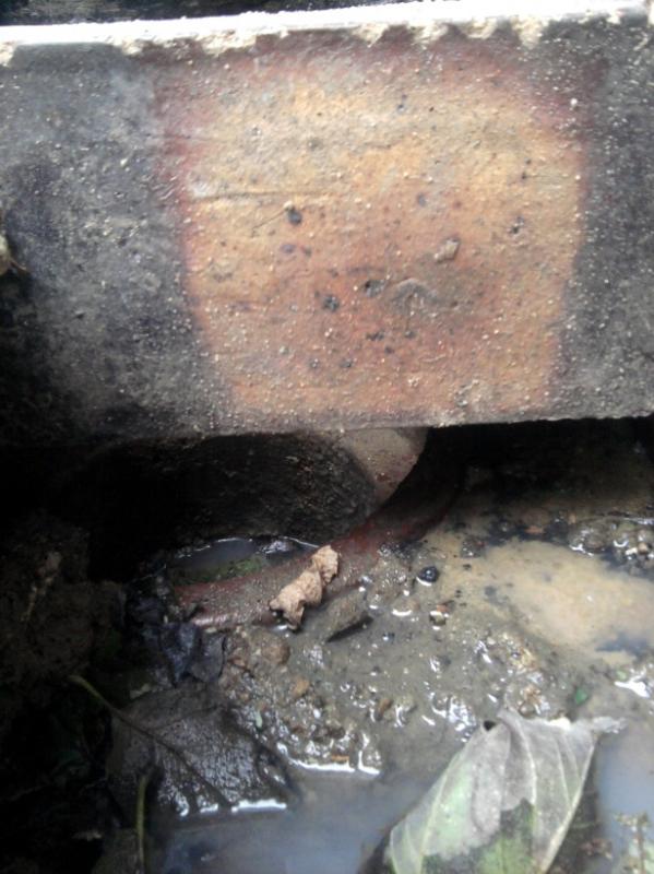

As you can see from the first picture, the circular aperture on the underside of the grid has been grossly misaligned with the circular drain in the ground. It’s off by at least an inch and a half. More worrying is the fact that it’s completely open – the grid is sort of suspended by the concrete and house bricks above the drainage system – so all the waste water spills over into the surrounding clay and, presumably, the brickwork and foundations of the house.

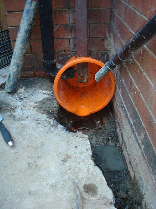

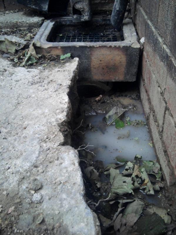

The gulley that you can see (in the third picture) with pooled water in it is due to the fact that I removed a piece of drainpipe that had been buried, with one end stuck between the grid and drain, and the other end supposedly providing a run-off for the patio area (it was useless as the pipe was full of clay). Total bodge. Occasionally, if the drain ever gets blocked, the kitchen begins to smell.
How do I correct this? My thought was that I’d replace the grid that collects the assorted waste water and make sure that it actually funnels the water into the drain. I assume there is a metric-to-imperial connector that would do this? I’d probably need to excavate the surrounding concrete to align it properly, before re-filling the gulley with concrete to secure it in place?

Personally i'd look to removing the entire gulley and replacing it with a plastic gulley. If you carefully excavate and expose the drain back to a clean section of pipe, you can (very carefully) cut the drain and fit a suitable collar to convert to plastic.
Fernco are one manufacturer of such collars, Wickes also do something similar. Once connected to plastic, fit your new gulley, bed and haunch it with concrete to secure it in position.
I'd look to fit a 'bottle' gulley. This type have the added advantage of allowing rodding access from the gulley, and may not require bends to align the outlet to the existing drain.
The 'Osma' bottle gulley has side boss connections, with a 110mm 90deg bend and an adaptor the black downpipe could be accomodated to enter the side of the gulley. This may help avoid water splashing onto the surrounding brickwork.

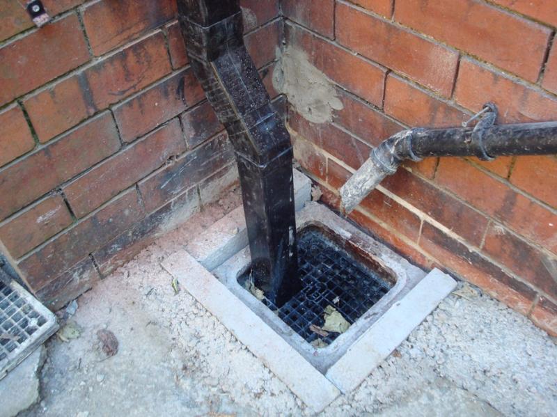

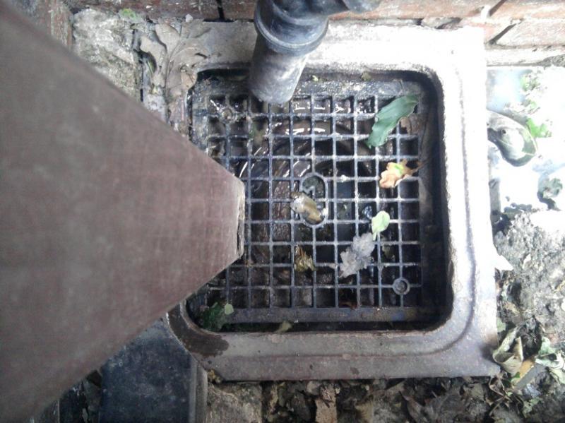

I decided that the suggestions made were probably beyond my level of competence. Cutting a pipe embedded in the ground felt a bit risky. As such, I decided to fix the existing gulley by realigning the hopper over the drain.
Made a temporary fix and left it for a few days to see if the area remained waterlogged (wanted to ensure that the existing gulley wasn't leaking).
British ingenuity at it's finest!
After satisfying myself that it was OK, I reset the hopper.
Need to replumb the kitchen paste straight into the hopper. Chances are, when I re-lay the paving, I'll raise the hopper to be flush with the new floor level and use a rubber adaptor.
Looks a good job done. If you're not worried about appearance, swap the bend on that waste for a 45deg compression waste bend, and a longer piece of pipe into the gulley. Sorted. ;)
