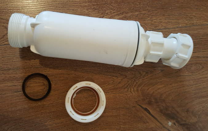

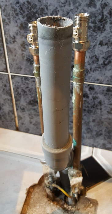

This is the existing trap - I've dunged it out, and would like to re-use it, unless you chaps tell me different... I've shown the waste pipe that goes into the ground too.
I'm assuming I'll need new washers top & bottom - can you buy them separately?
Ah - actually, I think it's one of these ;)
In which case, they do seal kits - but there are 32mm and 40mm versions... does that refer to the outside diameter of the grey waste pipe, or something else (that seems to be more like 34mm, but hey, it's close...)?
Its the 32 mm kit ( or new trap ) for basins. Sinks ,baths and showers are the bigger size.
No harm at all reusing the trap. If the washers are in good nick you can just clean them up.

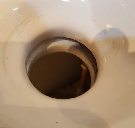

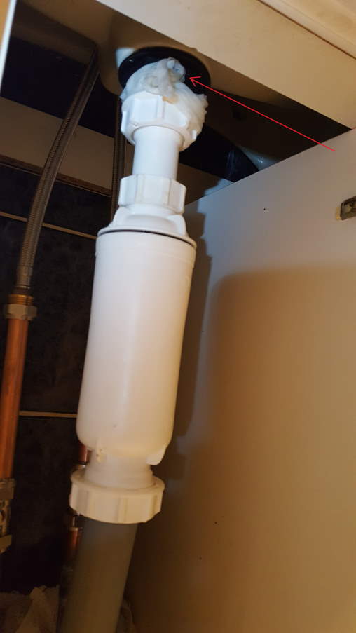

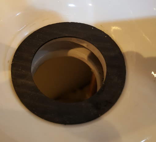

The water is appearing (in volume) where the red arrow points. A couple of pics of the sink waste hole too.
Nope, it's leaking down past between the washer/big nut and the threads. Don't worry about it, it's a typical place to leak.

The big black nut and the washer is what holds the waste into the basin. The leak is coming from the bottom of the nut at the washer and/or at the join with threads?
The slots in the slotted waste allow water to run out to the gap between the body of the waste and the throat/overflow section of the basin, doesn't just run from the overflow to the waste. That water then runs down past the usually badly designed washer and the black nut. You can see the gap that I mean when the basin is upside down before you put the washer and nut on. You need to plug that gap from the basin waste edge tight to the threads, the washers supplied usually aren't design for the job, a failing of the waste manufacturers tbh, some do supply a domed washer that can helps but not always, depends on the size of the gap.
That's why you can now buy a basin mate either that or use some silicone to plug that gap.
