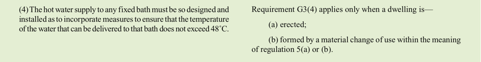

I take it all other taps are hot? Do you get really cold, or lukewarm? There’s sometimes not an explanation of a thermostatic mixing valve (TMV), which blends hot and cold water, under the bath especially on a new build. This would mean you only get a maximum of 48 degrees centigrade from a bath hot outlet.
This is a legal requirement of building regulations, document G, section 3 (G3). I’ve attached a copy of the wording for you.
The other issue you may have, besides the TMV, is unbalanced supplies. Do you know what type of hot water system you have?
