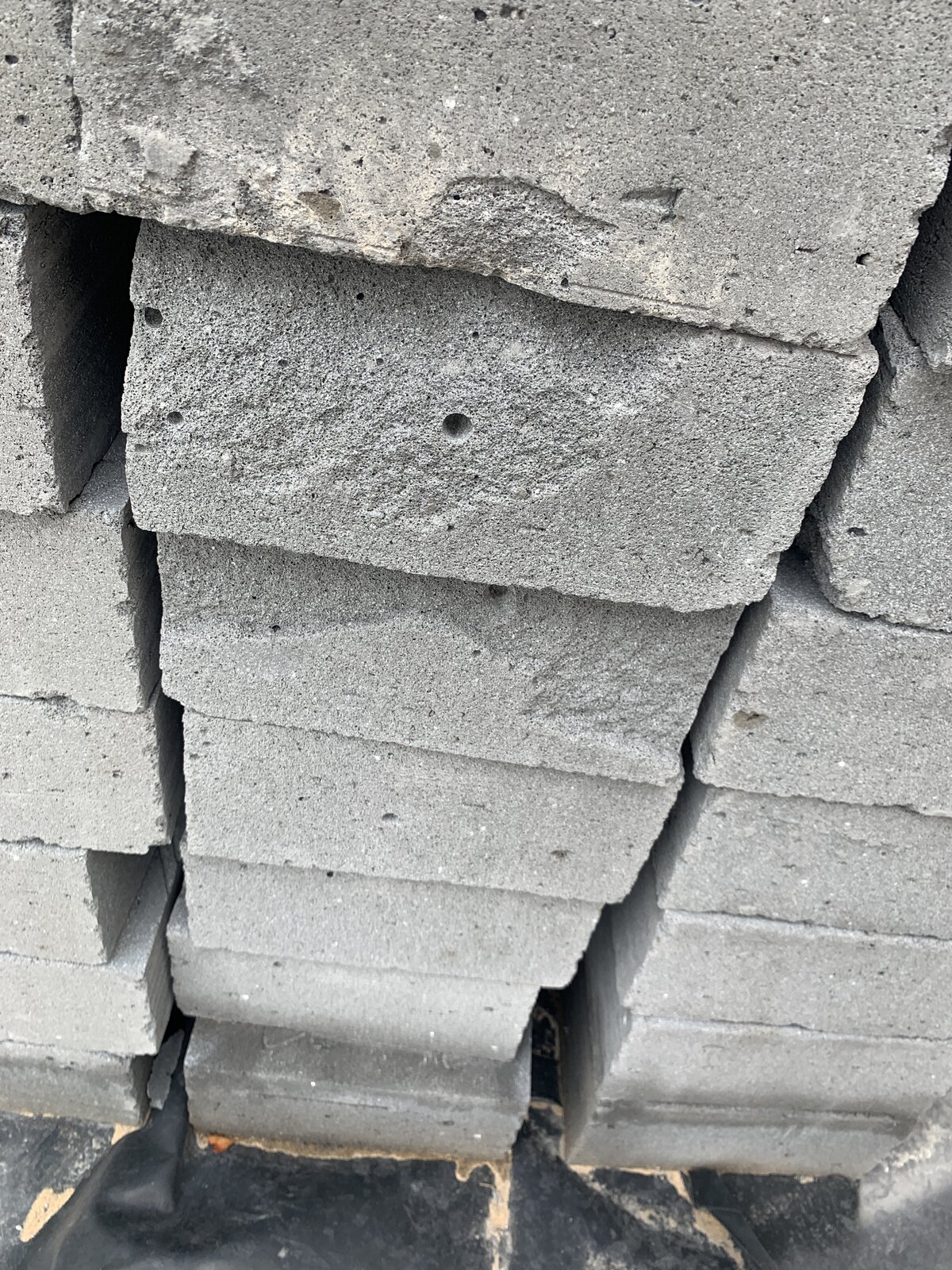

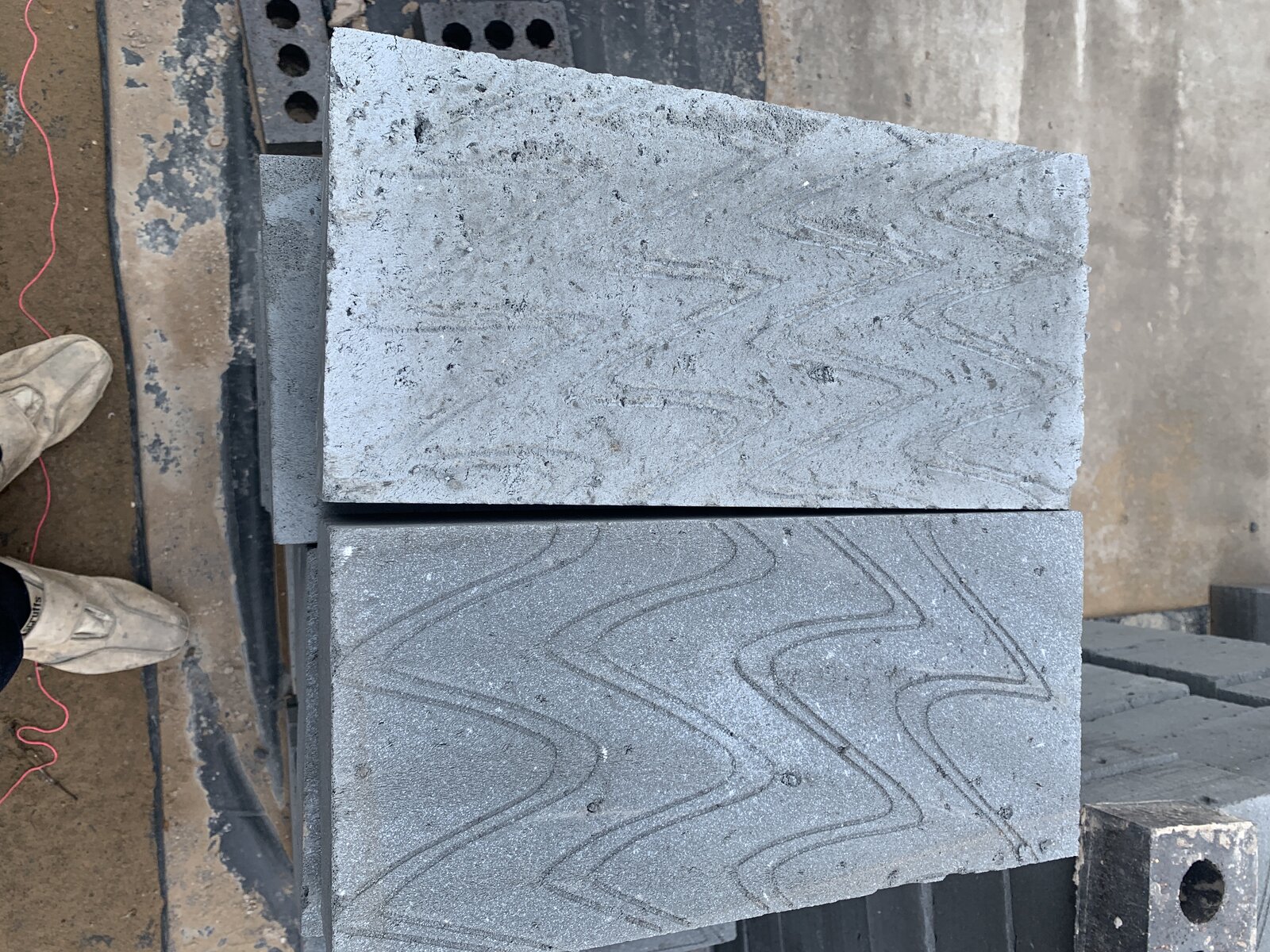

Also within the different packs of thermalites there is serious variation in the quality of the surface - I will take a picture to show what I mean.
In a lot of these things I know you have to allow for some wastage, but I'm not sure what's considered reasonable and what isn't.
I'd say about 20% of the thermalites are like this.
And they vary in face quality quite a lot - both blocks taken out of separate packs of thermalite - all with the branded plastic wrapping so confident they're all the same type of block.
This only problem for me as I have a garage wall which will be on show, so trying to get the 'nicer' thermalites to use there.
Are they seconds?
Normally these blocks have dead neat edges, often several are actually stuck together, and they are in a nice wrapped cube block.
Agree the ones in the top pic look cr@p and nothing like what new blocks should look like.
Are they seconds?
Nope, not seconds - as least not what I ordered.
All wrapped up on delivery for me, nothing to indicate they should be seconds.
The packs were stacked 3 high on my lawn which isn’t particularly even when delivered which has caused a big of movement in the packs, and caused some of the chips I guess.
Worth contacting Thermalite for quality control?
