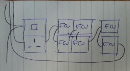

Basically, I have the 45a oblong one (vertical), next to a bank of FCUs (in a 3x3 pattern).
We would like a socket amongst the FCUs.
The route of the cables is from the left of this bank of FCUs, with the cooker control first, so it would be easy to retro-fit a single socket into the FCU/sockets circuit (which is obviously different to the cooker circuit).

What I had in mind:
Ideally, you could get a vertical one with socket.
There is one brand which does that. Seen them on ebay. One of the cheaper brands in white.
Can't find it now! I think it was a volex or similar
Why do you want all them FCU's for ?
I'm not a big fan of central grid switches, but would think it would look better than all those fcu's ? ??
