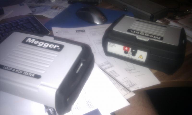

Tell you what, why don't you buy my LRCD210 and MIT310 off me and you can go and do them for him.
I let my tickets lapse this year 'cos I have enough to do with the gas an unvented side of things.
Need a calibration, but they are otherwise factory fresh.
Sorry, what were you saying? :roll:
Thought so.. ..
Thought so.. ..

Little rusty - hence the need for the kit to be calibrated.
But I would have the bonding checked from supply head to fuse board, then to the gas and water services (16mm and 10mm respectively), then your earth loop impedance, ze+zs...
This is of course assuming the whole lot is capable of the extra draw.
Want to buy this kit now? Or are you going to spend the evening trying to out belligerence me? 'cos I have had a crappy day and more than happy to.
